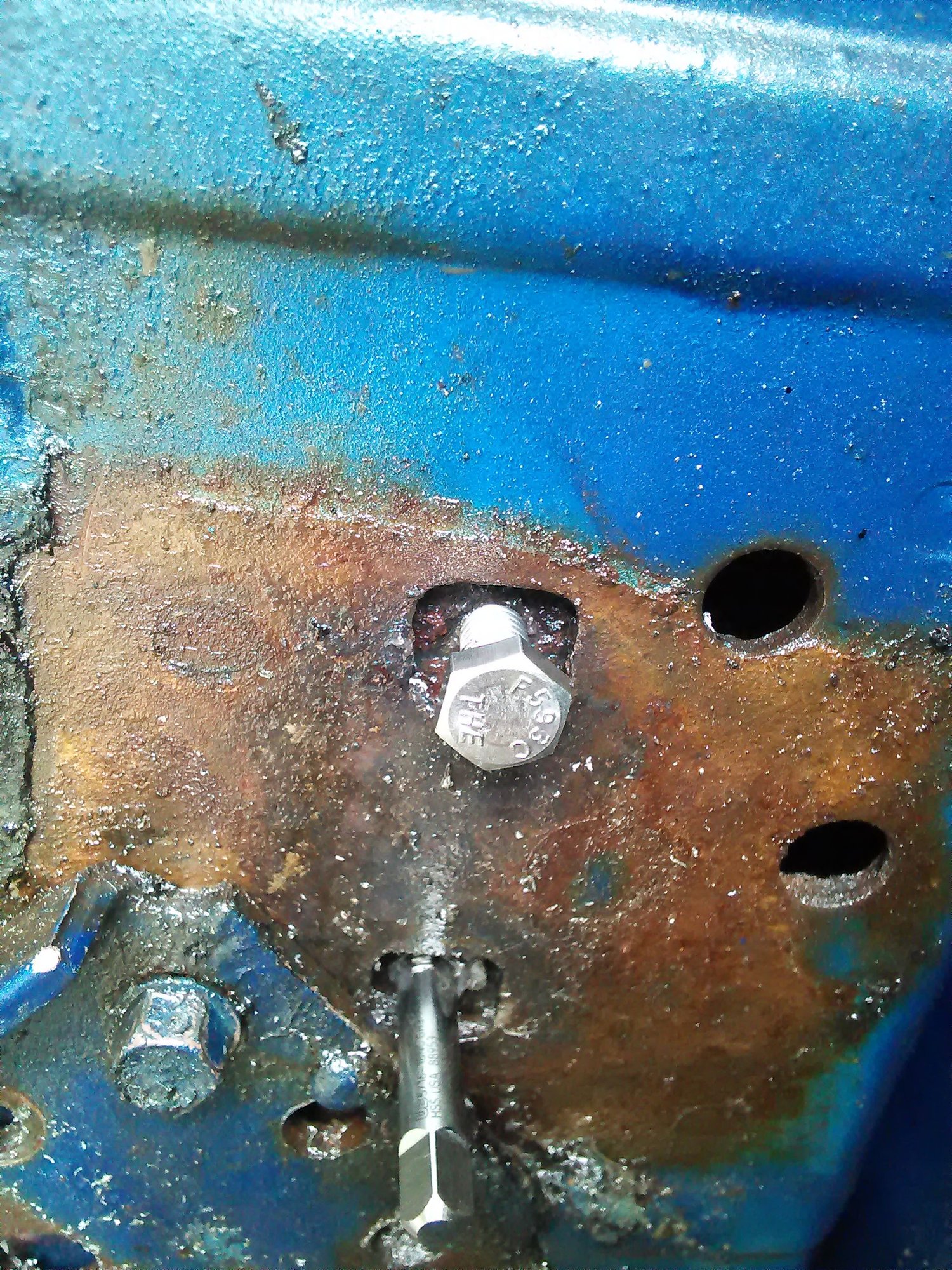

My hinge bushings are worn out and my door started sagging a little more, to the point where I had to lift it to get it closed. I hate that on any vehicle, just hate it! The striker 'pin' wouldn't go any lower, so I figgered I'd simply loosen the bolts at the A-pillar, and raise the door up a little. Well, two bolts broke on the lower hinge, and on the upper hinge, one of those same two bolts broke - and the other was already broken...
Then I spent nearly two weeks messing with getting the fender off. I encountered some stuck bolts along the top of the fender, and found one bolt they'd driven in, which was too large. Here's the one I had to drill out:
This one tore the inner fender:
I started drilling the two lower bolts a few days ago:
And today I drilled them out to 1/4" and tried a little additional wallowing with the drill. I couldn't get the bolt to collapse, so I wallowed them out as best I could, and started with the tap:
I used a 5/16 - 18 tapered tap. It threaded nicely into the door's hinge-backing plate. I also bought some new bolts at the hardware store.
O'Reilly drill bits:
SO now I'm half done, but at the more challenging part, the upper hinge. One bolt is totally covered by the cowl, while the other will still need long drill bits, as the drill itself won't get in there:
What is the best way to go after those upper hinge bolts?

I don't have a welder, so I drilled out the lower bolt stub, and tapped it. I'll have to either get a welder, (and learn to use it - a possibility) or figure out something else to get at that top bolt. I figure that like the old song says, two out of three ought to keep the door hanging on there for now.
I also put washers under my hardware-store bolts. I need to get some grade-8s. I used a block of wood on a trolley jack to support the door while I preliminarily 'aligned' it. Then I adjusted the striker as high as it would go, and lifted to door to get it to latch fully. I then hammered lightly on the hinges to get them to move some, and tightened it down.
I loosened the striker and closed the door. I then lifted slightly and opened the door while trying to not move the striker. I tightened it back up and the door closed nicely. It was sticking out too far, so I adjusted the striker inward. That got the door aligned good enough.
I then put the fender back on, and threw a battery in the truck and moved it into the driveway. I might drive it to work tomorrow if it's not too hot out. It's nice to have it ready for mundane daily-driving, rather than being available only for truck-tasks, which have been non-existent lately...
