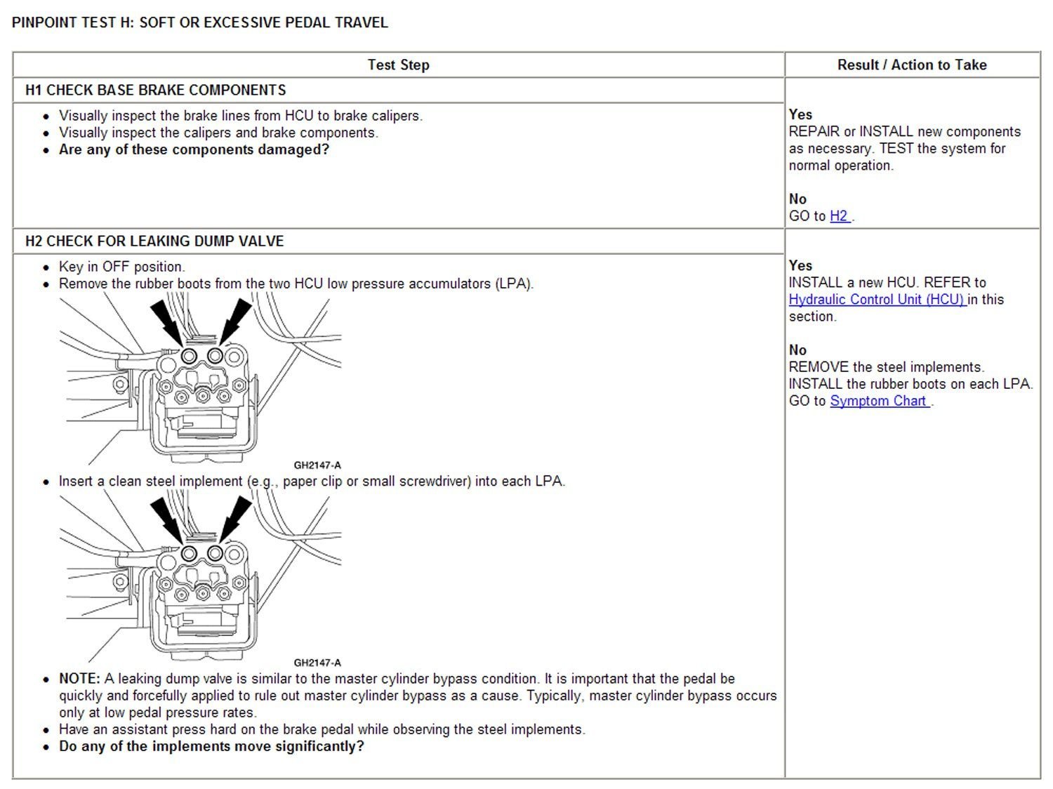

Master cylinders can do that and there’s a lot of aftermarket new ones that bypass due to poor quality. The pressure supply (power steering pump) would only cause a hard pedal, the hydroboost can cause a number of weird events, but a sinking pedal isn’t one. The ABS unit can internally bypass a valve causing a sinking pedal while filling up its internal accumulator. There’s a simple If that’s the issue.
