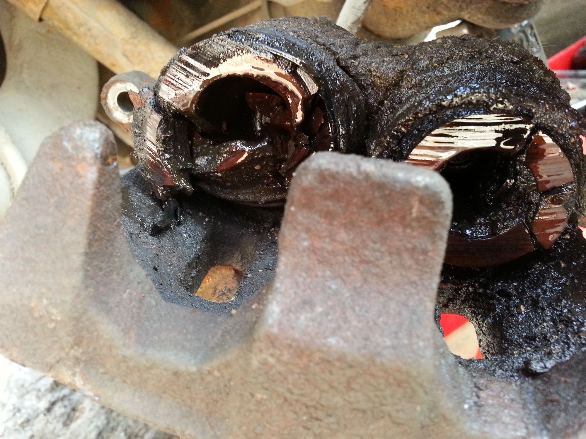

Inspect for leaks and find fluid from right rear calliper. It is crushed like rocks never have I seen a piston fail like this.

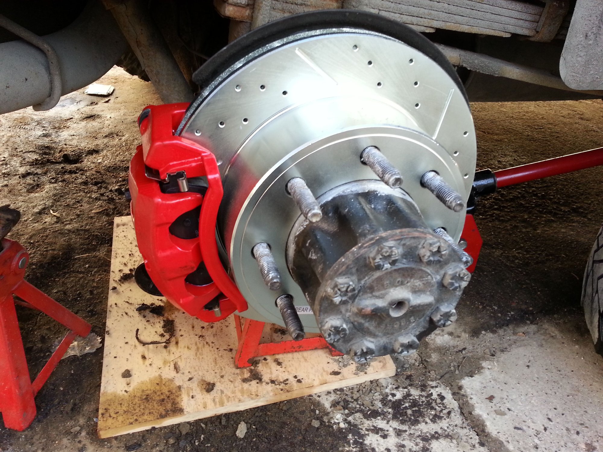

So I order up the power stop kit from Rock. I put them on the front last year and they have been awesome. Vented drilled slotted rotors, ceramic pads, new callipers and brackets. Change everything over and start the bleeding. And more bleeding and more bleeding. Bleeding furthest from master cylinder to closest. Yes i'm bleeding properly not my first rodeo.

Crushed
