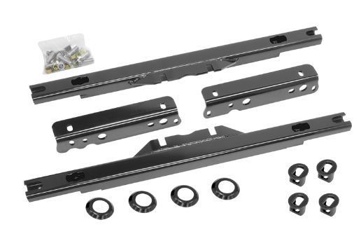

This is the Reese Elite kit;
Compare this to the earlier post showing the Ford kit. Similar, but not the same. The Ford crossmember is all one piece including the receiver pucks. The Reese kit is bolt together, and you have to buy the gooseneck plate separately.
I'm not even sure Reese actually builds the Ford kit. They definitely do not sell it.
That is one of many kits Reese makes, albeit the one without the GN prep. They also make one with the GN hole which is the one Ford uses.

That's the Reese kit with the gooseneck plate, yes. But it is bolt on. It is the same kit in my earlier post, it just comes with the plate but it is still bolt together. It is not the one Ford sells under their brand.

Right, the one Ford sells is one Reese makes specifically as an OE supplied product. Same product but all one piece due to no shipping constraints and installation before the bed is mounted. Both made by Reese and both install the same way more or less. So technically, you're right. They aren't exactly the same but close enough for government work. The hitch itself, on the other hand, is identical but for the sticker...
