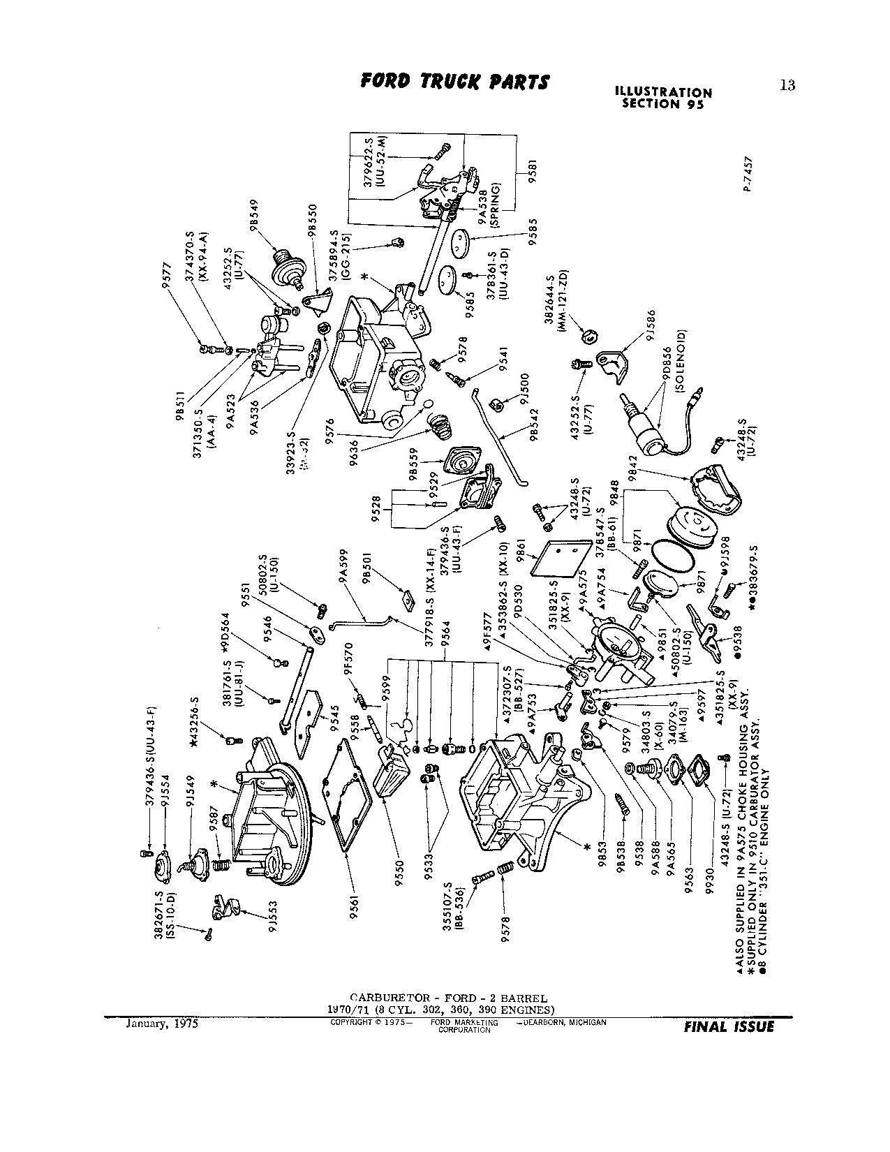

Originally Posted by Filthy Beast
I've never heard a power valve called an "economizer valve" but I've been wrong before.
FoMoCo: Economizer Kit aka Valve.
See 9A565 in upper pic.
Lower pic: I posted the wrong pic initially and with FTE's new format, I cannot delete it.
"Economizer kit" #9A565....just different gaskets listed. But I'm sure the valve is listed there somewhere, maybe not on that page, but somewhere.
Thanks, Bill.
9A565 is the basic part number for the economizer (aka power) valve, see pic.
