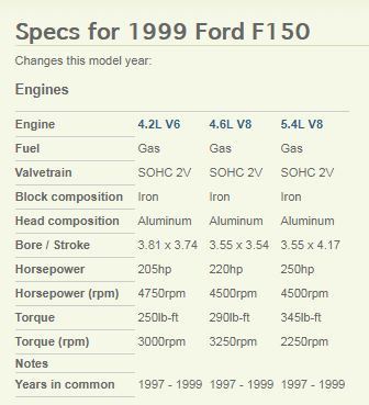

Mine is a 1999 with the "L" engine designation. Here are the specs I found.
