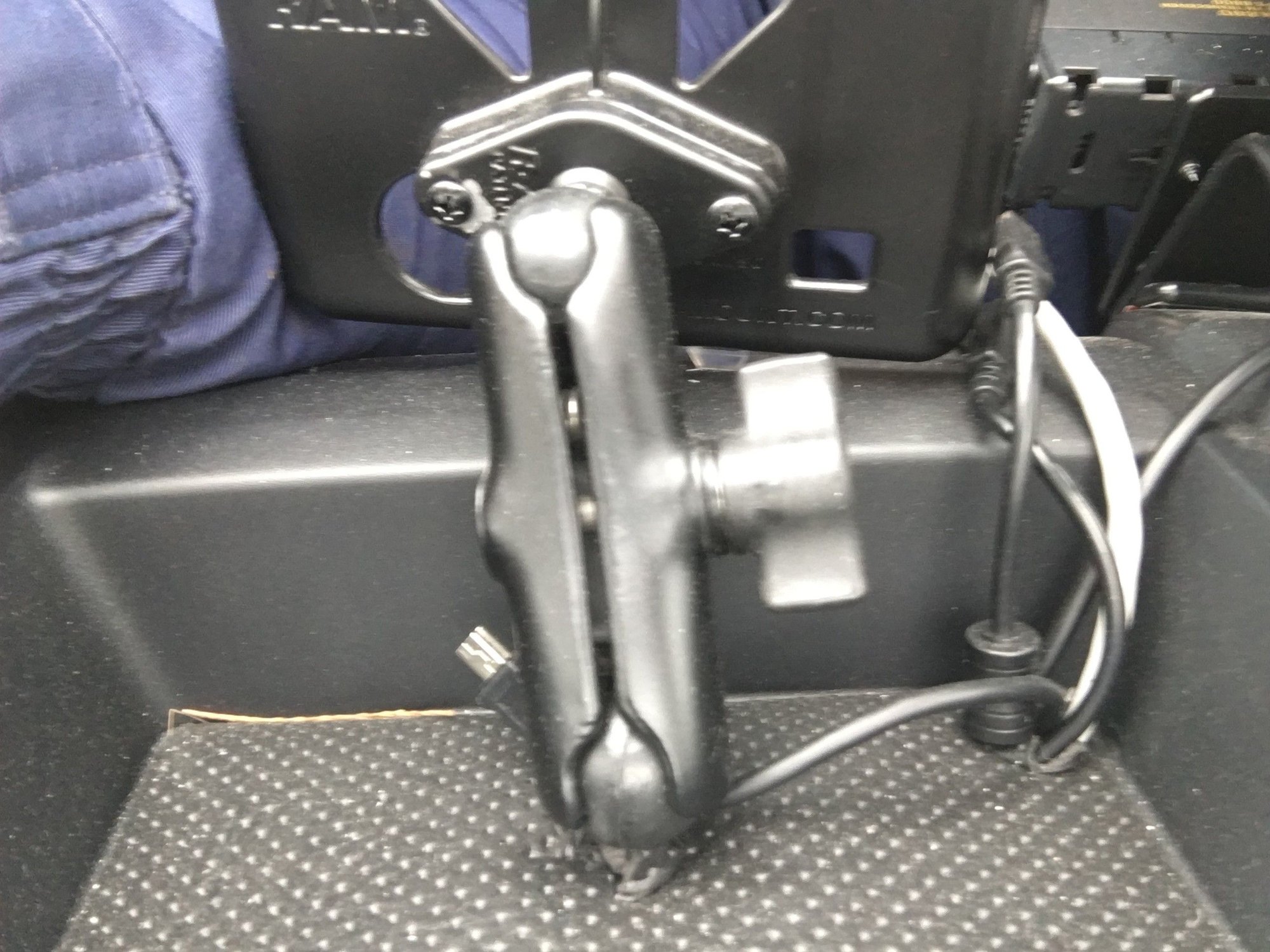

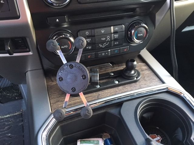

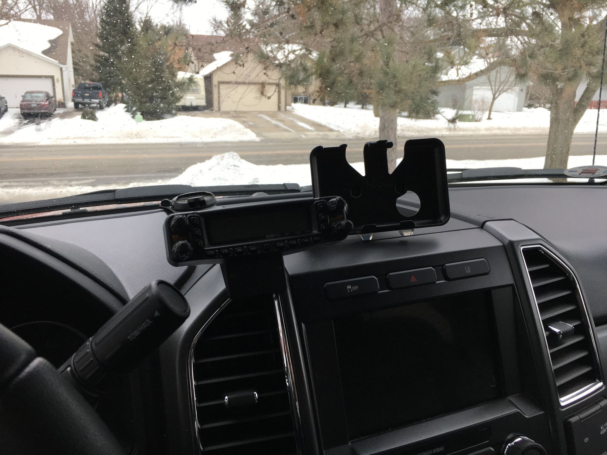

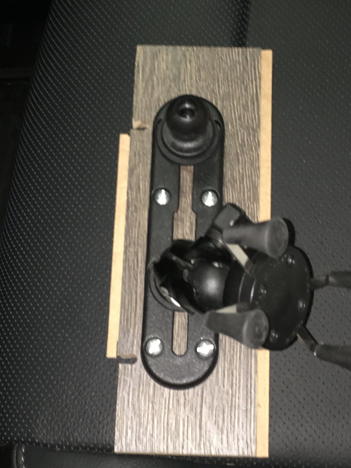

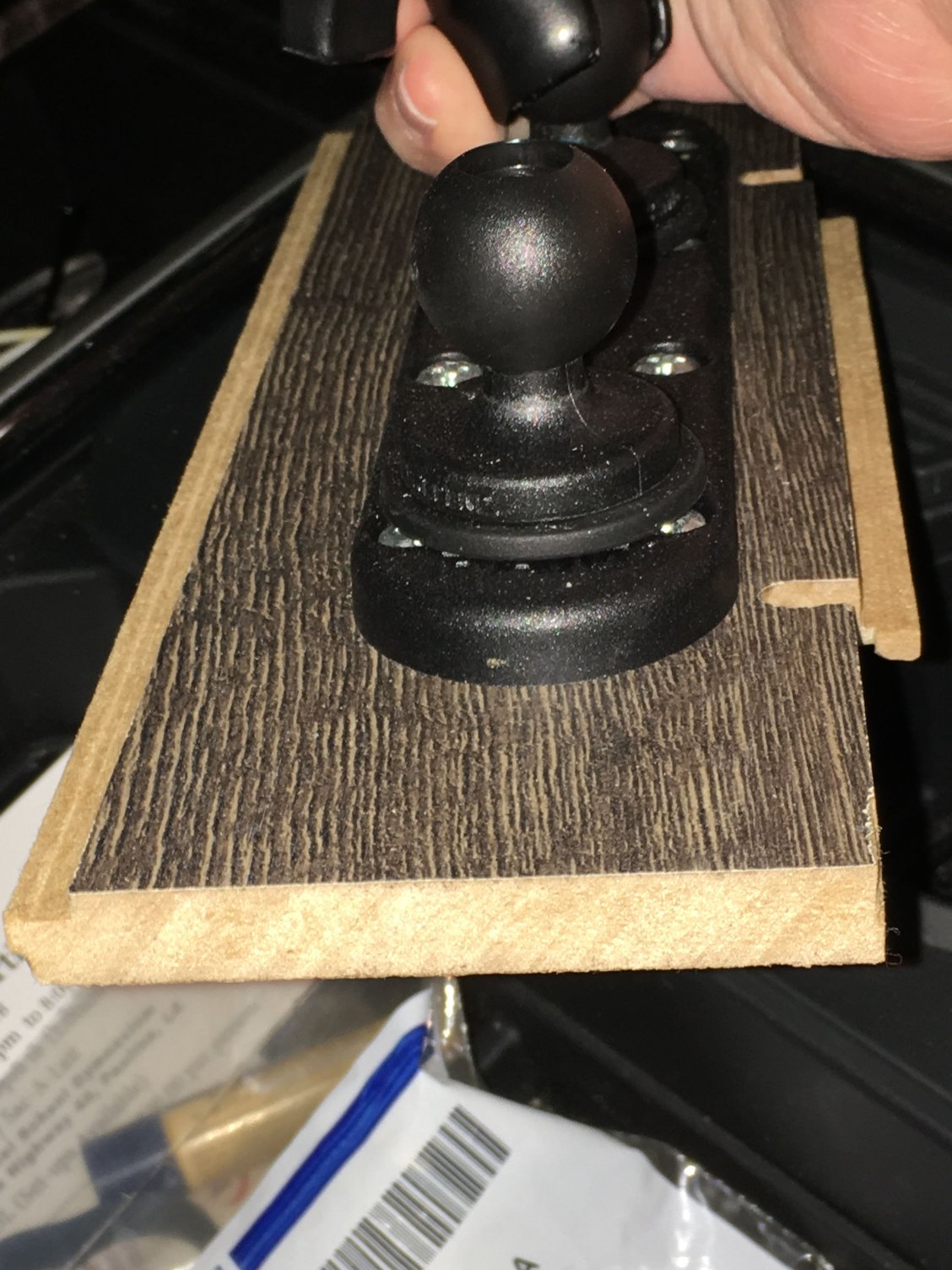

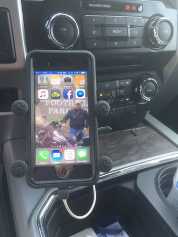

When I had the same thoughts on my 2011 & 2016 F150, I took the rubber mat off, removed the top center panel. I drilled a 3/4 inch hole to run power wires up and mounted a RAM ball with nuts & bolts. Had some rubber like shelf material that I cut a slit in for the wires so it looked good. When I traded for a 2017 F250, remove everything, covered the holes in the trim panel and put the original tray back in. Ran three power cables for GPS, camera, scanner and wires for my ham radio. This idea I got from what others had done.
Hope this gives you some ideas.
Added these pictures. The radio head and camara mount are on a proclip mount.

Like the pictures, still worth a thousand words. More work than I was originally thinking of but I like how the wires are routed and not laying or hanging on the dash. I'm thinking this is the route I will go for a cleaner look, thanks for sharing.
