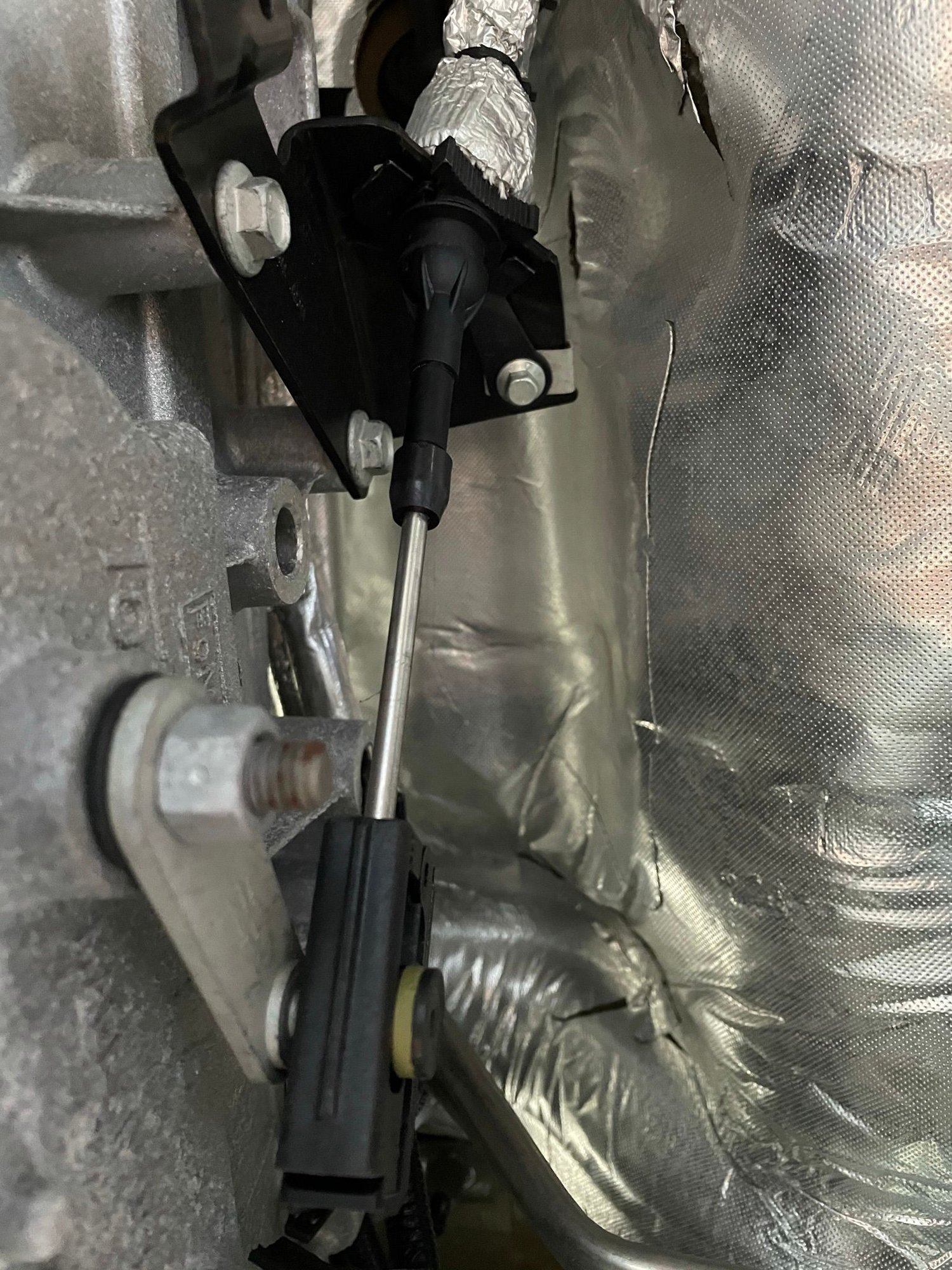

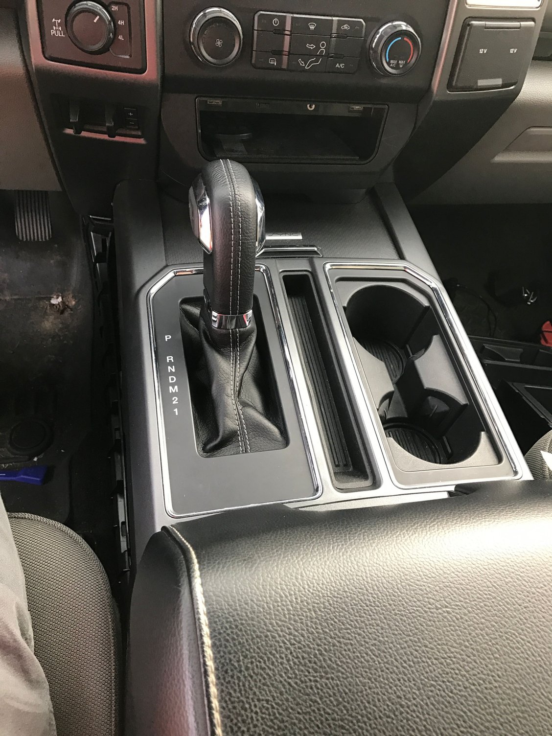

All I gotta say, is F that shifter cable! The F150's is too long...by about a foot...and the retaining clip on the transmission end is wrong. I got mine held in place with a hose clamp around the bracket. I got it shoved up in there, but I can't quite use 1st gear because it binds up a little. But I can use the +\- to achieve the same thing.

Originally Posted by mrmag00
Did you use the rims plus wiring harness? If so what did you think of it? Got any pictures of the harness?
I used BoostedGreyGoose's wiring harness. He is (was) a member here and makes awesome stuff for these trucks
https://www.boostedgreygoosedesigns.net/
Originally Posted by OffRoadRN
Personally I think the raptor steering wheel conversion with the power shifters is a better option.
Yup...I've had the Raptor wheel on my truck for two years + now. I can select gears from either the wheel or the shifter

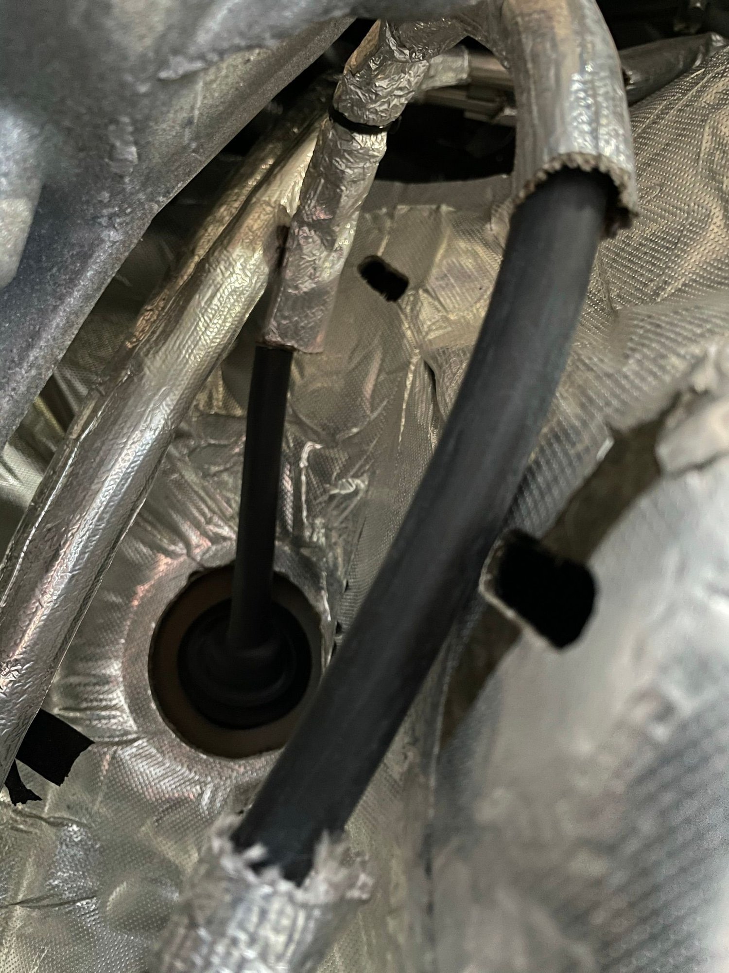

The F150 shifter cable is too long. When I did mine, it has a big bend to it...and the grommet at the firewall is at a strained angle. I've kept an eye on the grommet and it's still doing it's job.
The retaining clip on mine fit the transmission end the same as the original cable. And I have no binding in any gear.
It's one of my favorite mods and completely reversible if I decide to sell the truck and get no takers wanting the console shifter.

Sorry, looked for the email for the cable, but didn't see it. Took a couple pics of the cable installed, but didn't see a part# tag on it...not under the truck anyway.
I was able to use the original bracket/retaining clip at the transmission. It was a little tricky removing it from the original cable...seemed easy to break.
And a pic of the cable loop coming out of the firewall and the angle at the grommet.
