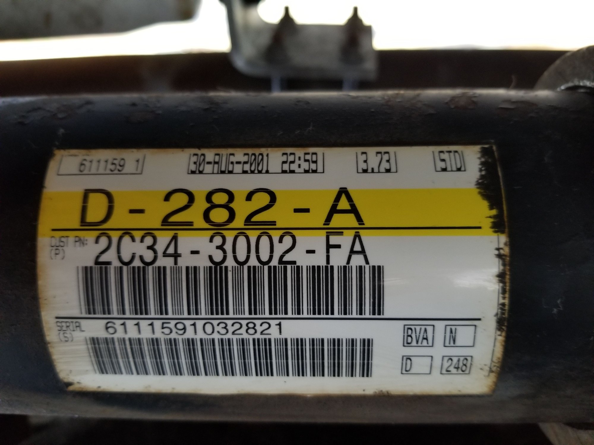

Front axle
These are the only marks/tags I can find...
Old Feb 25, 2018 | 01:32 PM
00t444e's Avatar
00t444e
Joined: May 2017
Posts: 3,523
Likes: 483
From: Southern OH
That's a Dana 60 the 248 at the bottom right of the last picture confirms that, Dana 50 would be 229.

I am amazed at how well those stickers stay there and remain legible after all those years.
Old Feb 25, 2018 | 01:47 PM
  #28
00t444e's Avatar
00t444e
Joined: May 2017
Posts: 3,523
Likes: 483
From: Southern OH
Yea mine where long gone when I got my truck 5 years ago.
thanks for that confirmation...
