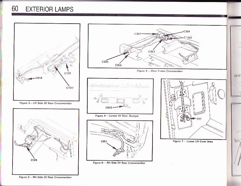

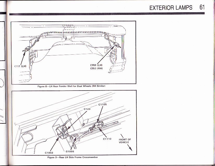

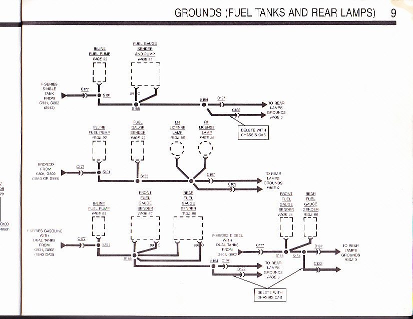

Originally Posted by NotEnoughTrucks2014
Any chance somebody has an EVTM print of this circuit? My Haynes manual just does not cut it here.
