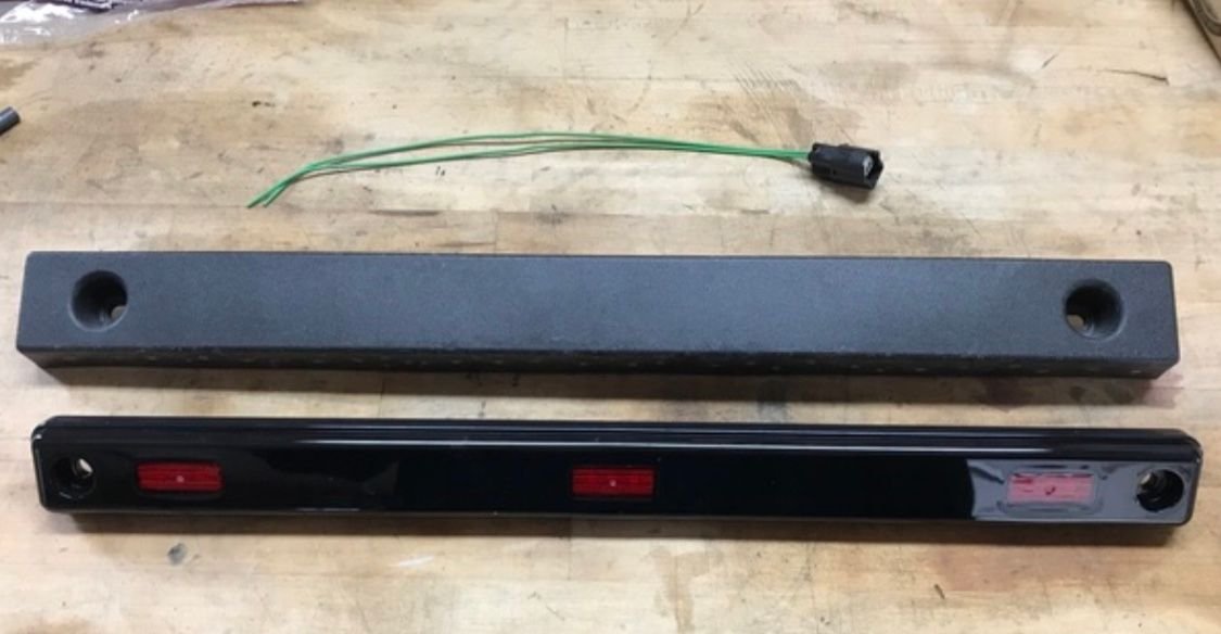

Here's a stock photo I found online of the parts and with it installed.
here's everything you need https://www.ford-trucks.com/forums/1...y-package.html
