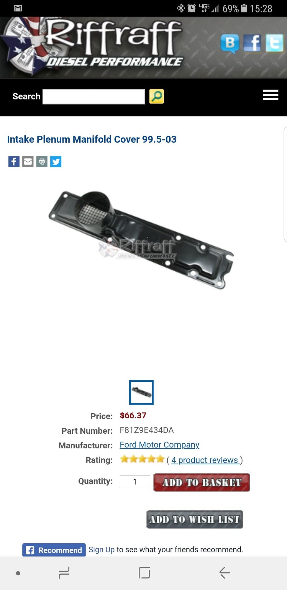

Before tightening clamps, oil would pool up on manifold and it would drip out and run down and make me think it was a rear main, after tightening and cleaning area, no more oil on manifold, but a small amount will drip from weep hole in torque converter area. What is the name and purpose of the part on head that the lower boots from pedestal attaches to, because it appears mine have been removed or replaced because i see gray RTV all around both heads.

I think you're talking about the plenum. This piece?

Thats it, exactly! Why would that have a need to be removed? I know nothing about the history of this truck, but it looks like they took good care of it mechanically.

The plenum opening where the book goes is very easily crushed if the clamps are over tightened. There are billet inserts available to keep from crushing it. Perhaps it was damaged before and they had to replace it? Can't really think of any other reason to remove it. Not necessary to remove for cups, injectors, turbo, or really any other general maintenance type items. Are your boots and clamps factory original? The factory plenum clamps are worm gear clamps, not t-bolts. It it has t-bolts then the above scenario is way more likely

Mine are red colored and have regular hose clamps.

That grey sealant is what they use from the factory. It is also what you want to use if you ever remove the plenums.
