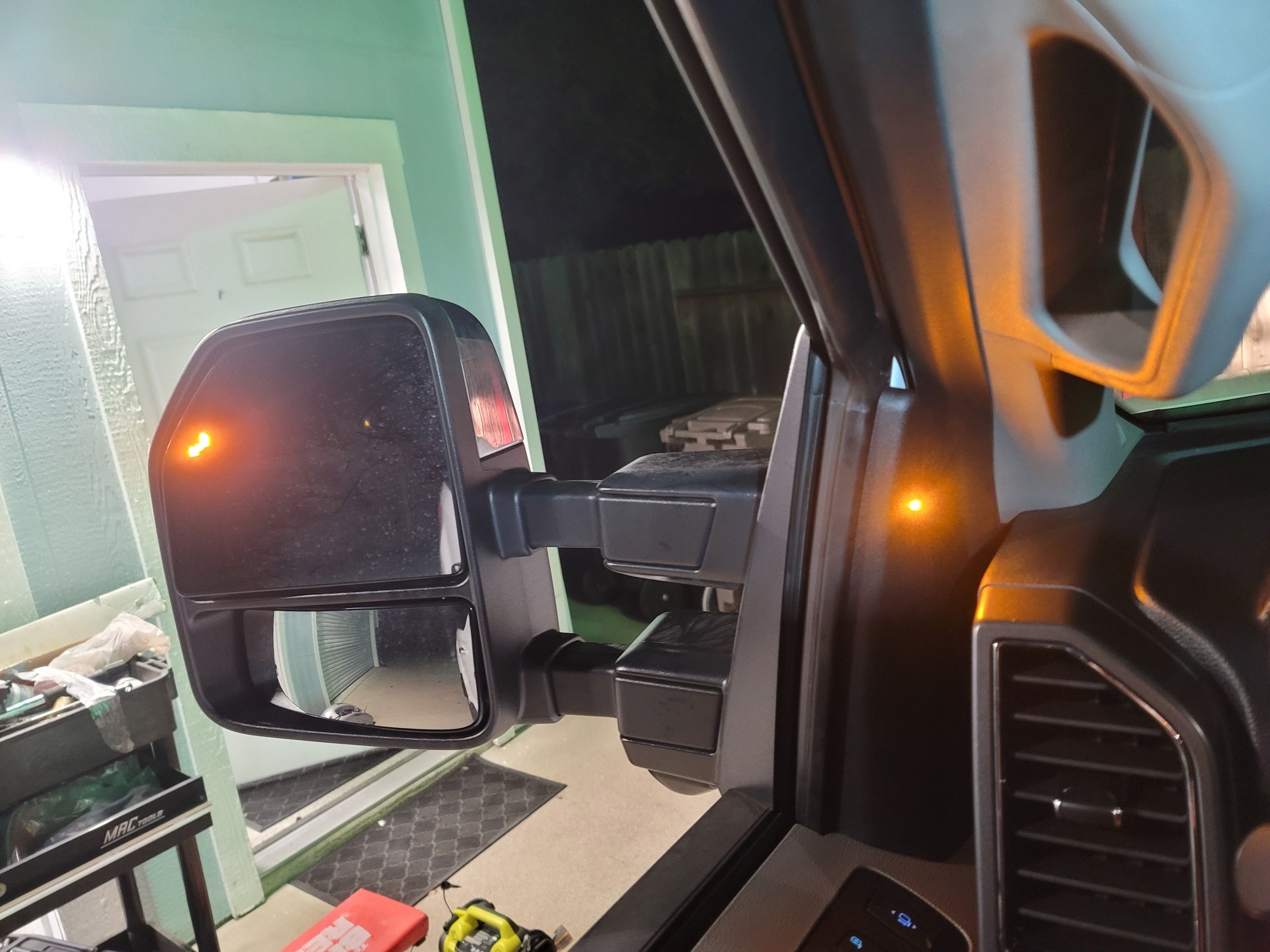

I was just looking at the parts. You can also just add a resistor in series to dim it down if needed... gonna try this myself
That you can... The photos were taken "pre resistor"... I soldered a 3K ohm resistor on each LED. Dimmed it substantially...

So final word is the 3K ohm resistor is needed?

In my case, yes... without it it would be a bit too much. Just solder it in-line on one LED pigtail, and either shrink tube it, or tape it... you can go with a 4.7K resistor if you want to dim it a tad more...

Hey, fairly new member here and just wanted to say thank you @Precisionair for this thread! I too had trouble seeing the BLIS indicators as well on my 2021 XLT, especially when extended in tow mode.
This was a great and easy mod! Maybe 10 minutes a side! I cheated and used t-taps but the wiring was spot on and this write up was super easy to follow!
Got two small LEDs from amazon, drill & install to the mirror covers, wire the two wires to pin 13 & 20 just like he wrote and done! I bought amber lights to match the existing BLIS indicator and was going to add a resistor but tried it out and they don't seem overly bright to me so I'm just going to leave it!
Thanks again for the help!
