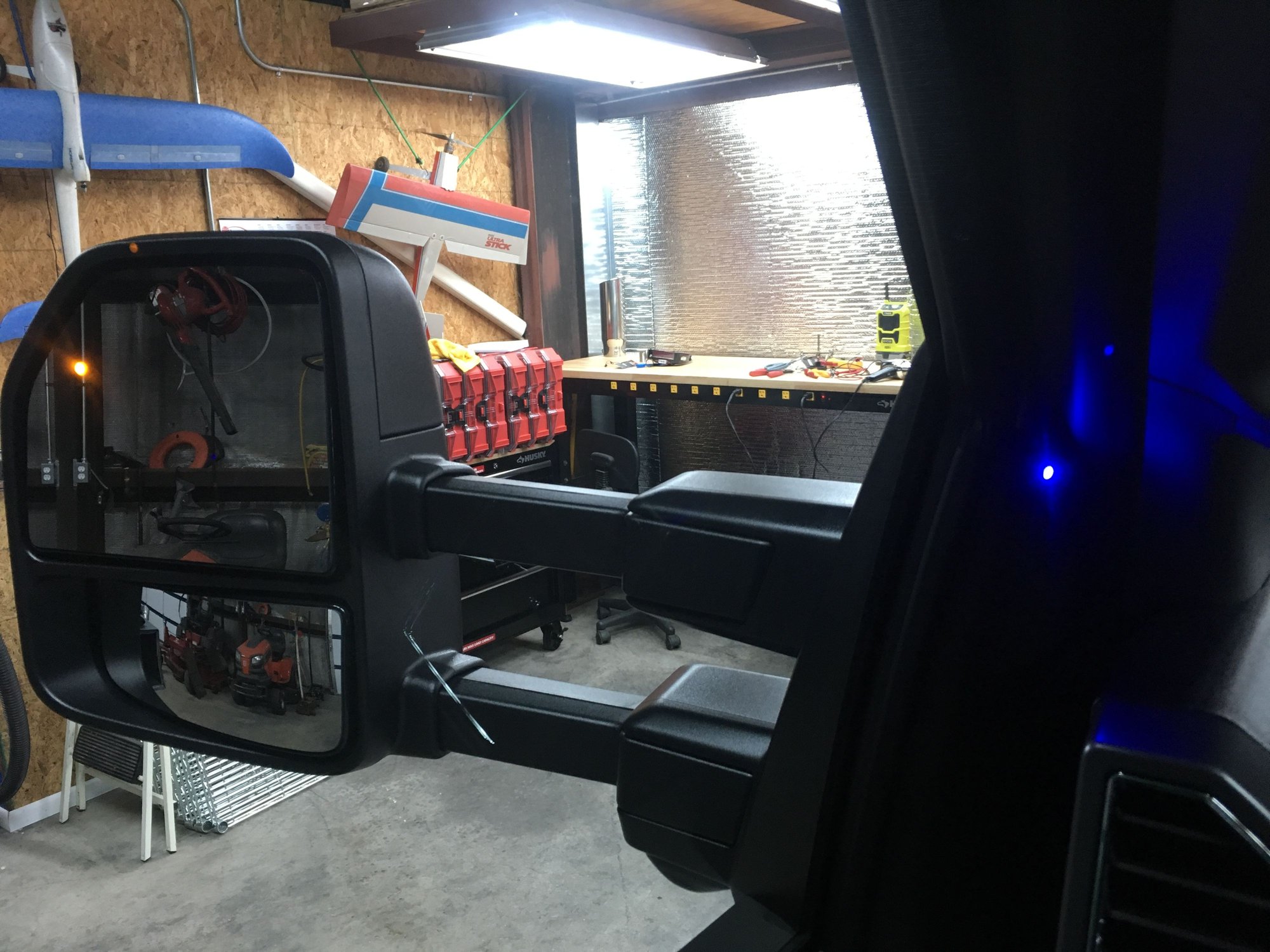

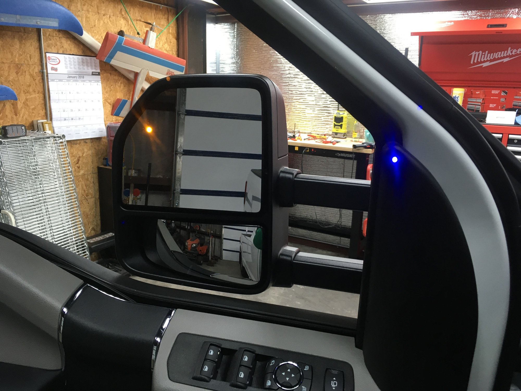

I soldered in a 3k ohm 1/2 watt resistor in each LED pigtail. Seems to have eliminated the glare...

Thats cool, should make the modification easier... I like it... after the 3K ohm resistor was soldered in on one leg of each LED, the one in the mirror is now brighter...

Follow-up... So far, with night time rear traffic headlights blasting off my mirrors, the additional indicators have been a welcome addition with better "got my attention"response from my peripheral vision...Like others, I trust my mirrors as well, but will take all the extra help technology has to offer. no glare, no irritation, no regrets...
