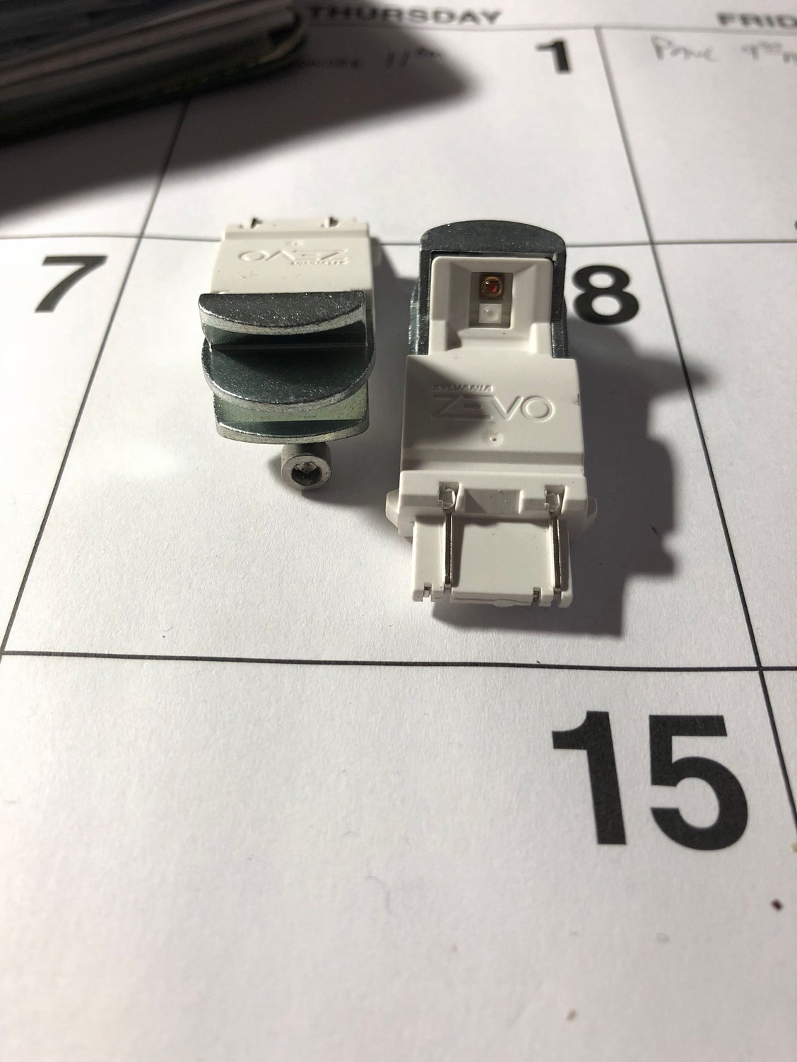

Went to install the Zevo 3157R today. I don't know if I'd read it someplace or where I got the idea in my head, but I ordered red. A red LED inside of a red lens does not appear to be anywhere near bright enough.
Did I screw up? I think these better go back to Amazon. Their chart says it fits, which is does. No mention is made of correct color.
The fitment site on Superbright shows a 3157K, which I believe to be white. The current bulbs are clear, so it would make sense that the white is the way to go inside of a red lens. I'd appreciate a little guidance before I return one and order another.
However, further reading on Super Bright's website says, "LED emitting color should match lens color". Their bulb is a 360 degree beam angle. These Zevos are not. The pic shows them from each end. The LED chips face back toward the reflector of the lens. The rest is finned.

I use the red also, Tried the white/clear first and they looked orangish. Research I found said to match the color of the lens.

I found that also. But the Zevo only seem to have a couple of LED chips instead of a 360 range with several chips like Super Bright and others. I'm hesitant to put them in because they seem dimmer than the stock bulbs. In fact, the return process has begun. They're repacked and awaiting pickup from my postal carrier now.

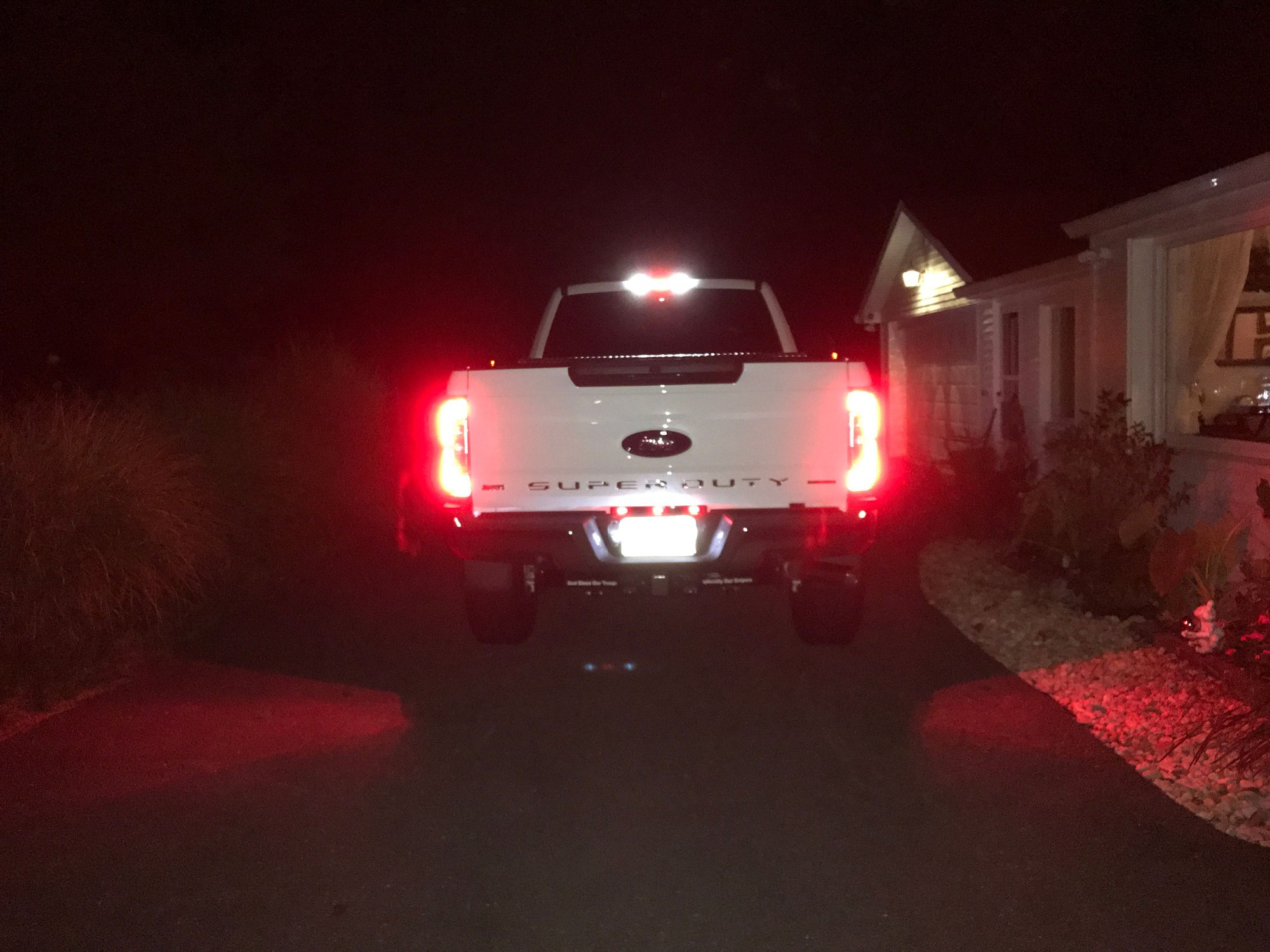

Mine are about the same brightness as the OEM during the day but super bright at night.
Running lights
Brake --- Look at the asphalt

I don't know, maybe it was just my eye but it sure appeared dimmer in the daylight than the halogens. The Zevos have been picked up and are on the way back to Amazon.
I'll see what Super Bright has to say on Monday. I emailed them with the experience I had and the photo I posted here.

In that housing, I believe you need LEDs all the way around to make full use of the reflector.

The SuperBright LED tail lights arrived and were installed today. Of course it's early afternoon so it's hard to tell how they're going to look later. But I do know that in broad daylight they're a hell of a lot brighter than the single LED chip Zevo I tried.
