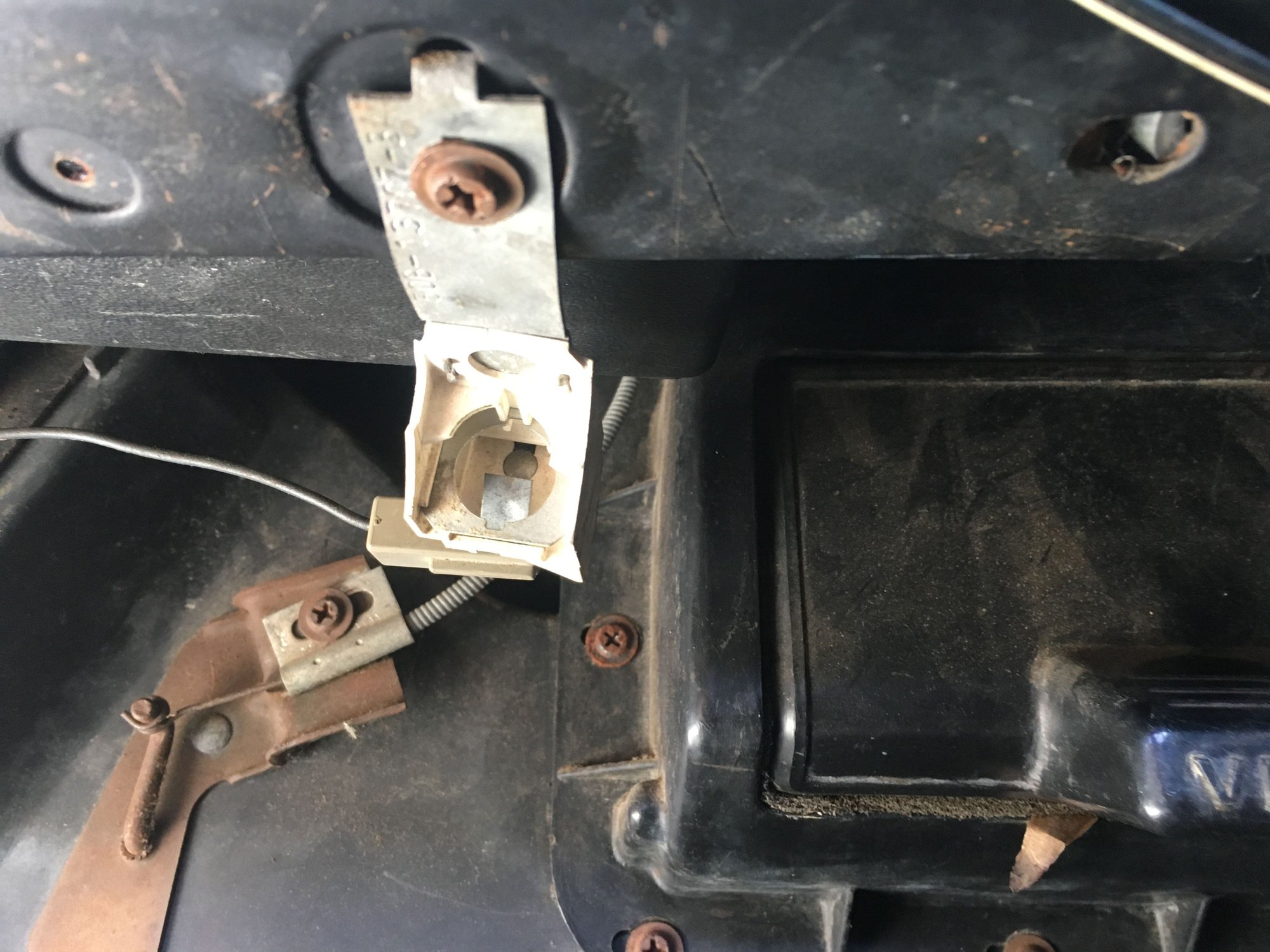

Does anyone have a picture of this light? I found something in my glove box that I've been trying to determine where it goes and there's a bulb just kinda hanging from the dash below..
Here’s a shot of the socket under glove box
