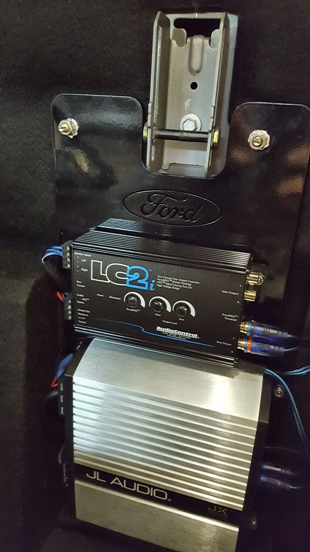

My 2017 XLT had absolutely no bass in the sound system. Could not live with that. I came up with a way to get one behind the rear seat, but was not easy. And I did not know if it would even sound good. Got it hooked up and it sounds very good. 1000% improvement over stock. I can't stress enough though----- it is difficult. I have a machine shop with all the equipment, I found out what NOT to do along the way. Ended up with a lot of time in it, but it was worth it for sure.
start with rear seat release
custom made amp panel and sub control
sub and sub box (extremely tight fit!!)

I purchased all the components at Crutchfield.com. A list of components is below. I would advise to check into one of the sub boxes some of the other guys have been going with (other posts)--- that were not available when I did mine. It appears they have sub boxes that will now fit behind the seat and you are also able to mount the components to. Its best if you find a competent system installer to actually hook up the system. It requires the head unit (radio) to be pulled and wired into. My truck had no sub woofer (Sony unit), but does have the Sync3. I did not change the other speakers out and I am happy with how it sounds. Well worth the time and money, makes a huge difference in the sound.
JL Audio JX500/10 amp
Pioneer TS 2502S4 10 " sub
LC2I sound processor
JL Audio sub volume control

I am not really up on the newer sound system installs and requirements. That's why I had an installer hook all my stuff up. But he did tell me that if I did not use the LC2i sound processor that he could have hooked up the sub with the wires under the drivers side kick plate --like you said. Since I did go with the LC2i (which he recommended for better sound) then he had to hook it up to the back end of the head unit. But don't think it had anything to do with the tweeters (but not sure about that). And I really recommend getting the Sub gain (volume) adjust--- as bass requirements changes on most every song played. And it really works out well putting the **** on the side of the drives side seat. The installer I had hook it up, had 30 years experience and got very good reviews. I would be very leery of taking it to some installers that hire kids (although they can also be good--maybe). He only charged me $90.00 to hook it all up ---- I would have messed around with it all day, and probably messed something up. So I was glad to pay that!

Since your truck was an XLT and didn't come with the Sony amp, where did you get the bracket that the LOC and amp are mounted too??

I made the bracket. I have a machine shop and waterjet. I was playing a bit and added the Ford logo when I cut it.

Ahhhh. That makes since. I manage a machine shop. Don't have a waterjet though. I ended up just using 1/2' HPDE for my rack.
