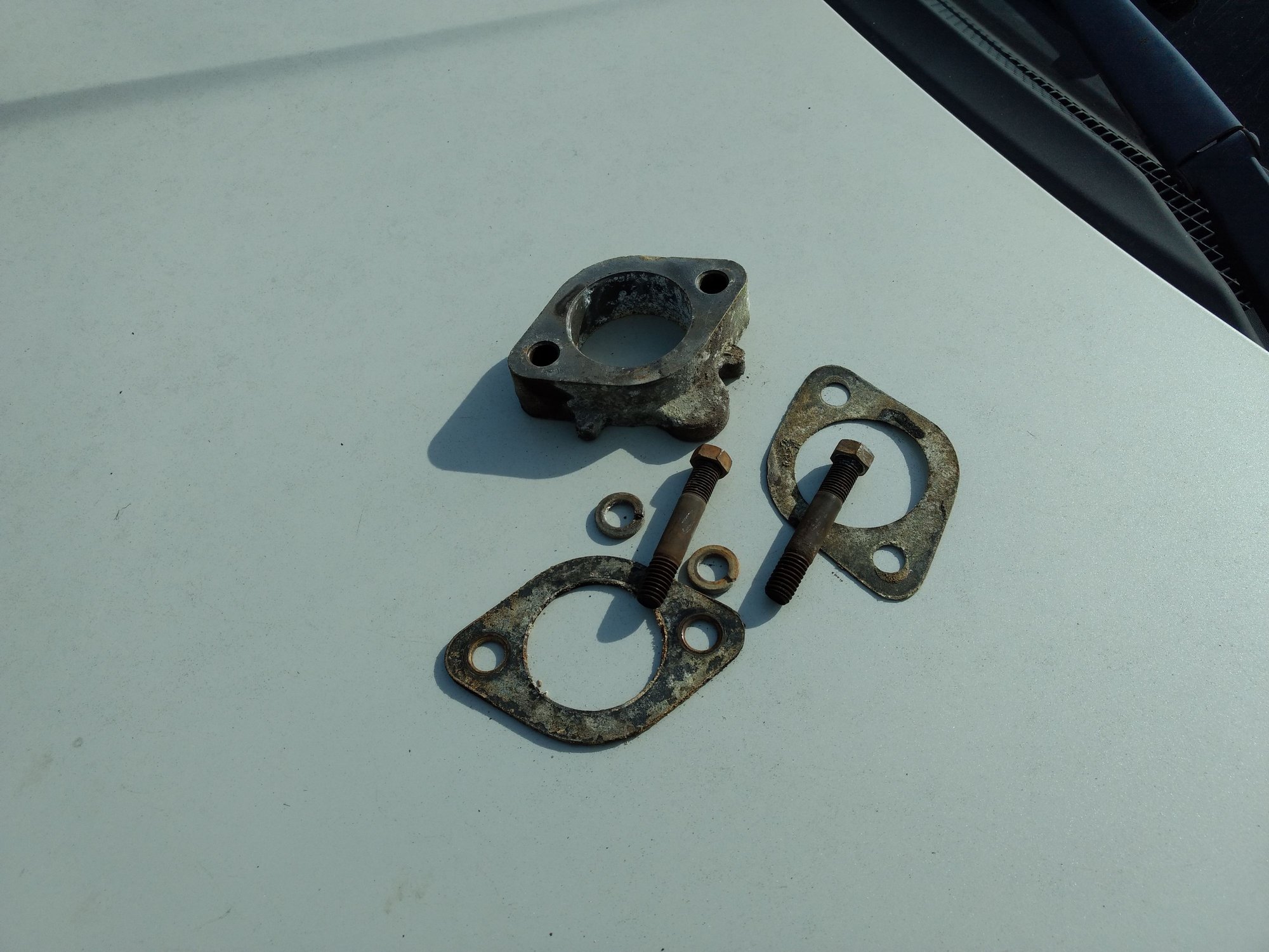

Went to work removing it.
Done deal

Pre-EGR spacer...

....which was discovered to not fit because the stud holes are not as far apart as what I have. Oh well.

Set a newer gasket over the base and use as a template. With a rat-tail file and 15 minutes, it will fit.

I appreciate your help bud but I guess I'm not comprehending. This is what I'm up against. Then also I would have to find/create another PCV port
If you look at the dent-side intake pic in the first post you can see what looks like a PCV port tapped in....on my 1980 the PCV port is in the spacer.

My experience was with a 1970 Carter YF carburetor, which I wanted on my 1986 4.9L engine. I did as you did with the later model gasket and used an ~5/16" round file and elongated the original holes [outwards]. It worked just fine and is still in use.
Regarding the port, you could drill and use a tap for threads to insert the correct sized adapter for the vacuum hose.
