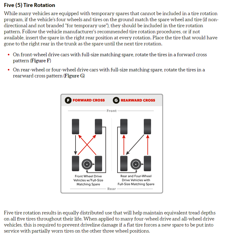

From tirerack
https://www.tirerack.com/tires/tiret....jsp?techid=43

I may be missing something but as I read it the op bought 5 new matching tires at the same time. If that is the case all tires would be the same size and would wear evenly as a set over time (also lasting longer as the miles are spread out over 5 tires not 4). This would the op to continue on the remaining 4 tires after a failure as if they were the original 4.
If the spare is only to be used temporarily then the op may have been better off using the best of the old tires for a temporary spare If he felt they were roadworthy.
