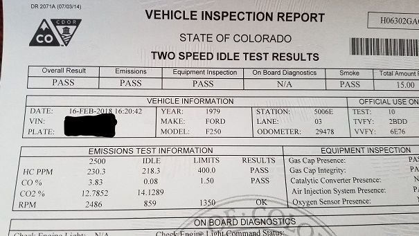

I was able to finally make it back to the emissions place yesterday. I wanted to get there much sooner than that but just didn't work out. First off, I want to thank everyone that gave me positive feedback and suggestions to try. Second, I wanted to post my results from yesterday so that everyone that was curious if I could get it to pass and for those nay say'rs that basically said I had a better chance at winning the lottery could see what my final out come was.
Firstly I thought it would be best if i did a recap on the modifications that are done to the truck so that everyone does not have to scroll back through all the prior posts to find it.
Engine Mods:
Stock air filter housing with air filter about twice as tall as standard air filter, Edelbrock 750 CFM 4 barrel carb, Edelbrock performer 400 intake manifold, 351 4v Cleveland heads, stock 351 4v Cleveland exhaust manifolds, single exhaust (modified y-pipe to adapt to cleveland manifolds) with Flowmaster muffler with 3in piping and turn down tip off back of muffler, 1 Magnaflow cat converter (required to pass visiual insp), gutted air injection pump (had to gut pump because the cleveland heads do not have the air passages in them, so the pump is just a dummy to pass visual insp), mild Edelbrock street/strip cam, full MSD ignition (6AL controller, blaster 2 coil, weighted advance distributor (non-vacuum advance)), 8mm plug wires, Motorcraft platinum plugs, 180 degree t-stat, EGR removed, thermatic system removed and Mallory fuel pump.
Adjustments/things I did to get the final calibration:
87 octane fuel (mid grade here, we are at a mile high above sea level), 10-12 degrees of timing, leanest jets and rods in 750 cfm carb per the Edelbrock tuning guide, disconnected the secondaries, getting about 15 in vacuum and about 860 rpm at idle.
Now the trick I used to get it all dialed in because the traditional method of tuning it with a vacuum gauge and tach just weren't doing the job:
Purchased a wideband UEGO O2 sensor/gauge kit from AEM, installed it and tuned the truck that way to get it as close to the stoichiometric ratio (14.7:1, which is 14.7 lbs of air to 1 lb of gasoline if you didn't know) that I could for before cat converter measurements.
Now as a comparison, here are my previous test results:
HC PPM: 2500 RPM - 701.8, Idle - 621.1, Limit - 400
CO%: 2500 RPM - 0.28, Idle - 0.21, Limit - 1.50
Now attached below is a picture of my final test results from yesterday. Thought a picture would be best to try and limit anyone saying that I just made the results up:
So as you can all see, even here at altitude and with those anti emissions modifications to the truck goes to show that with the right calibration and the will to do so that you can make almost, not all cars, pass the emissions test. So as a recap, the only working piece of emissions equipment on the truck is the aftermarket Magnaflow cat converter. All other emissions equipment has been removed or are just dummy parts to pass the visual inspection. Now time to go get its new plates. Thanks again to everyone that responded to my post with positive feedback. Hope everyone has a good and wonderful weekend.
