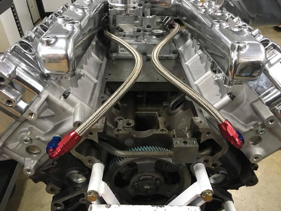

Speaking of, has anyone heard anything about Kill Devil's new ALUMINUM 6.0 head? They are prototype testing it with Charlie Fish's motor. He is shooting for 1000hp I think.
Interesting....
I've been following Charlie's adventures in head gaskets. This should be good.

I wish Kill Devil Diesel had more on their website. I guess all in due time.

I believe Jarod shows an image of them on his Facebook page showing the coolant hoses based on the coloration of the heads
