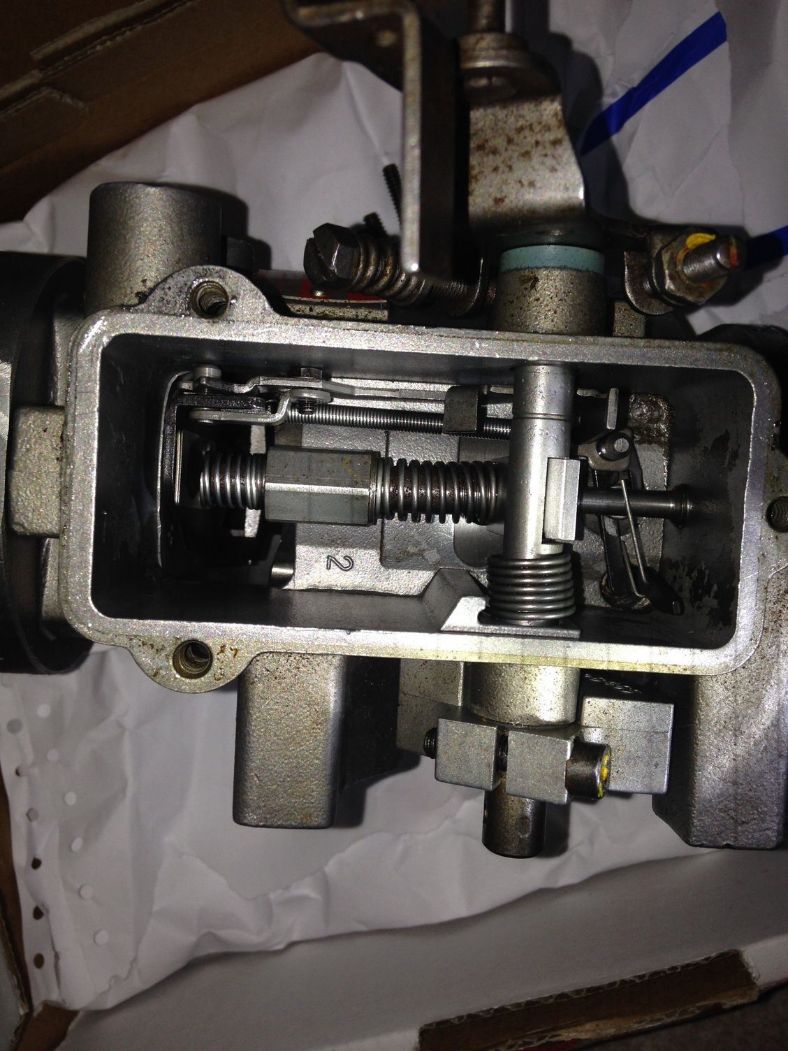

Hey Leroy, I've got a bad pump that I bought from an auto parts store that I thought was reputable, but quickly realized wasn't. This one was causing a surge/shake/miss then it would die, but I was getting air past the pump shaft seals; upon removal the shaft stayed with the drive gear. Idk if not having a shaft in it now would affect the movement of the parts in the top cover, but I just want to give you a heads up about it just in case. Other than removal and installation, I don't know much about the insides of these pumps lol.
Here is a pic of the top, and a vid of me moving the linkage. I hope this helps out some:

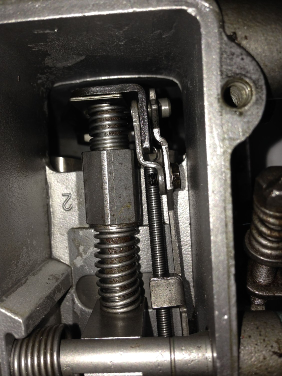

Here is a second pic at a different angle. I can't upload the video for some reason, it won't let me. There is quite a bit of movement in my linkage from side to side, probably a centimetre or a bit less from the housing wall on the pass. side in that corner out towards the governor spring

Thank you so much '73 for the pics .. Yep mine definatly has too much play in it .
The gov. arm doesn't sit at rest against the spring, so one of those parts must be worn or the shaft broken ..
