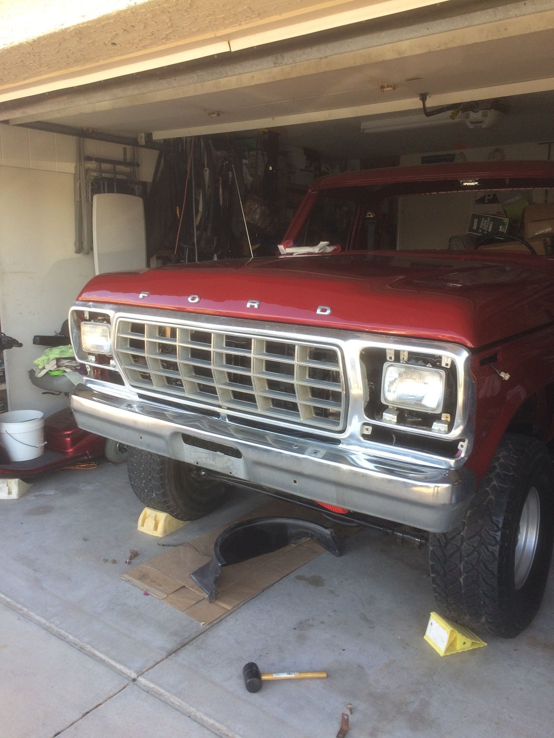

Come on guys, this is about getting power to the fuse block. The starter is still in the box. all this wiring is under construction. I tested the 3 wire plug to the fuse block and discovered that was the cure. I now have plugged in the 3 wire plug, connected the other end to the hot side of the solenoid. This step is missing from any instructions I have found (or was using) on installing a 1 wire alternator.
The body guy then showed up with the fresh painted hood and fenders so I stopped for now.
Thanks everyone for the comments, more to come.

Glad its fixed. Nice build

have seen his truck up close. Going to be a beautiful ride.
