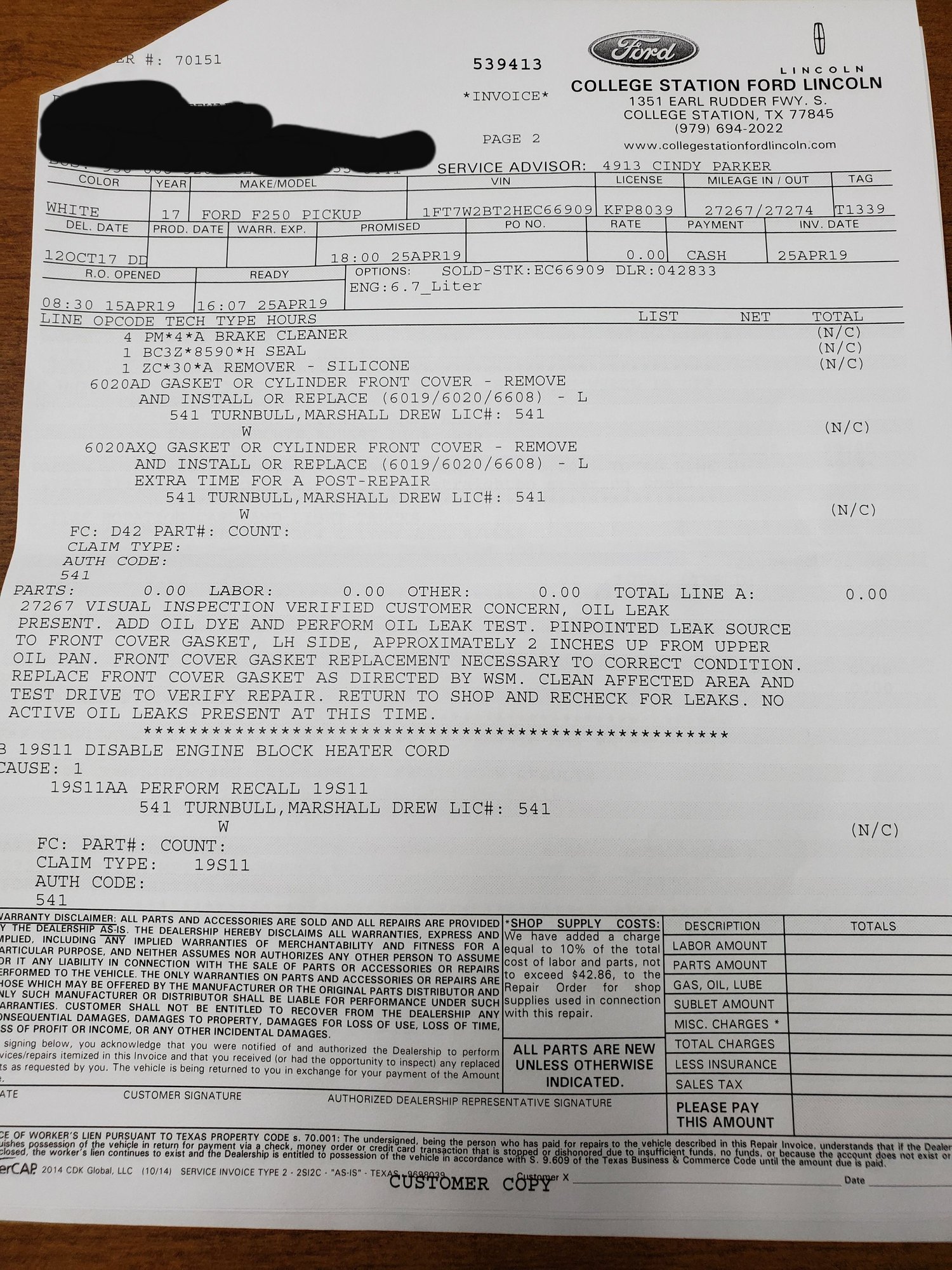

Just picked mine up from the dealer this morning. Fixed the leaking front cover and did the TSB for the "death wobble".
They pulled the cab/engine for the front cover repair and it looks like they did the pan too.

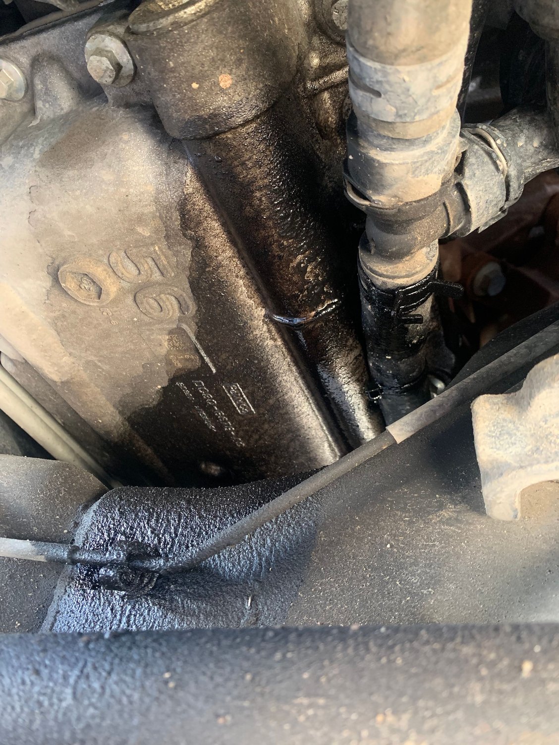

A buddy of mine took his in for this leak. The dealership just smeared some kind of sealant ON THE OUTSIDE. Twice! He's communicating with ford hq to see what's up....

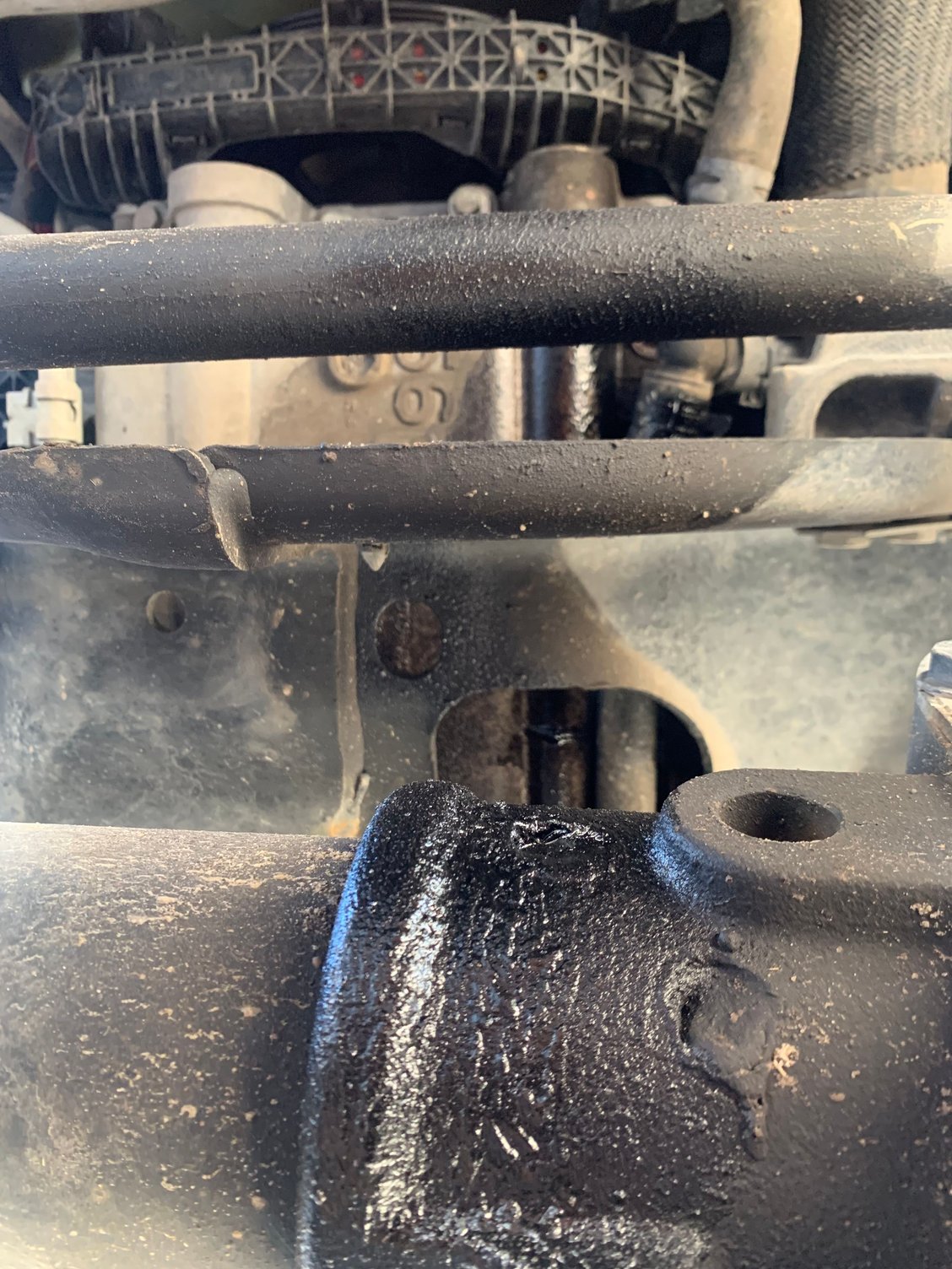

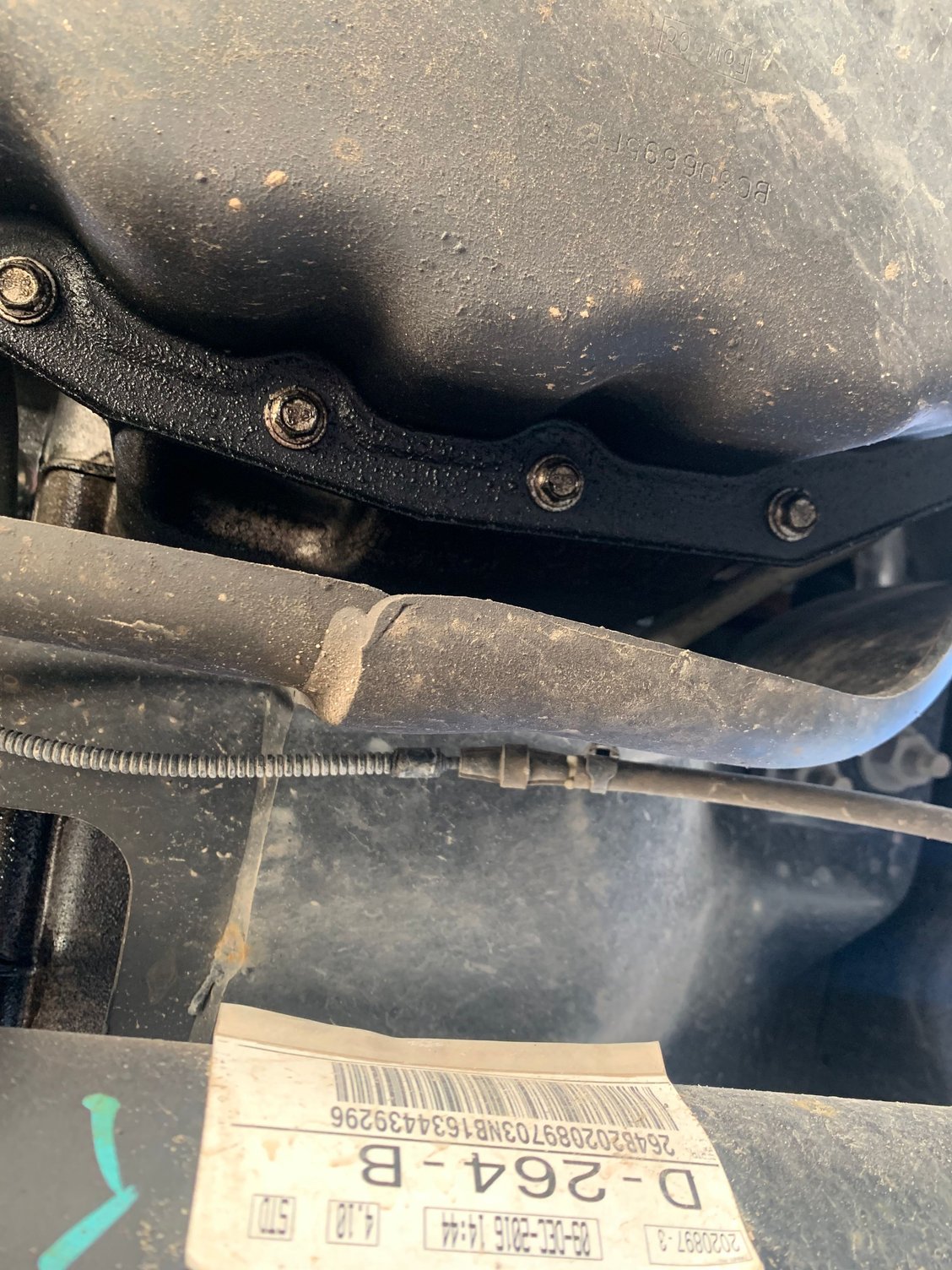

This dealer told him they do 2 or 3 a week so they "know what they need to do". Here's a screenshots from a video he sent me of the work done. You tell me what it looks like, maybe I'm seeing it wrong...
Wow, looks like a 2 year old got into the toothpaste. I cannot believe they let a truck leave the service department that way
And that kind of work makes you wonder if they bill Ford for the proper fix hoping they get away with it
