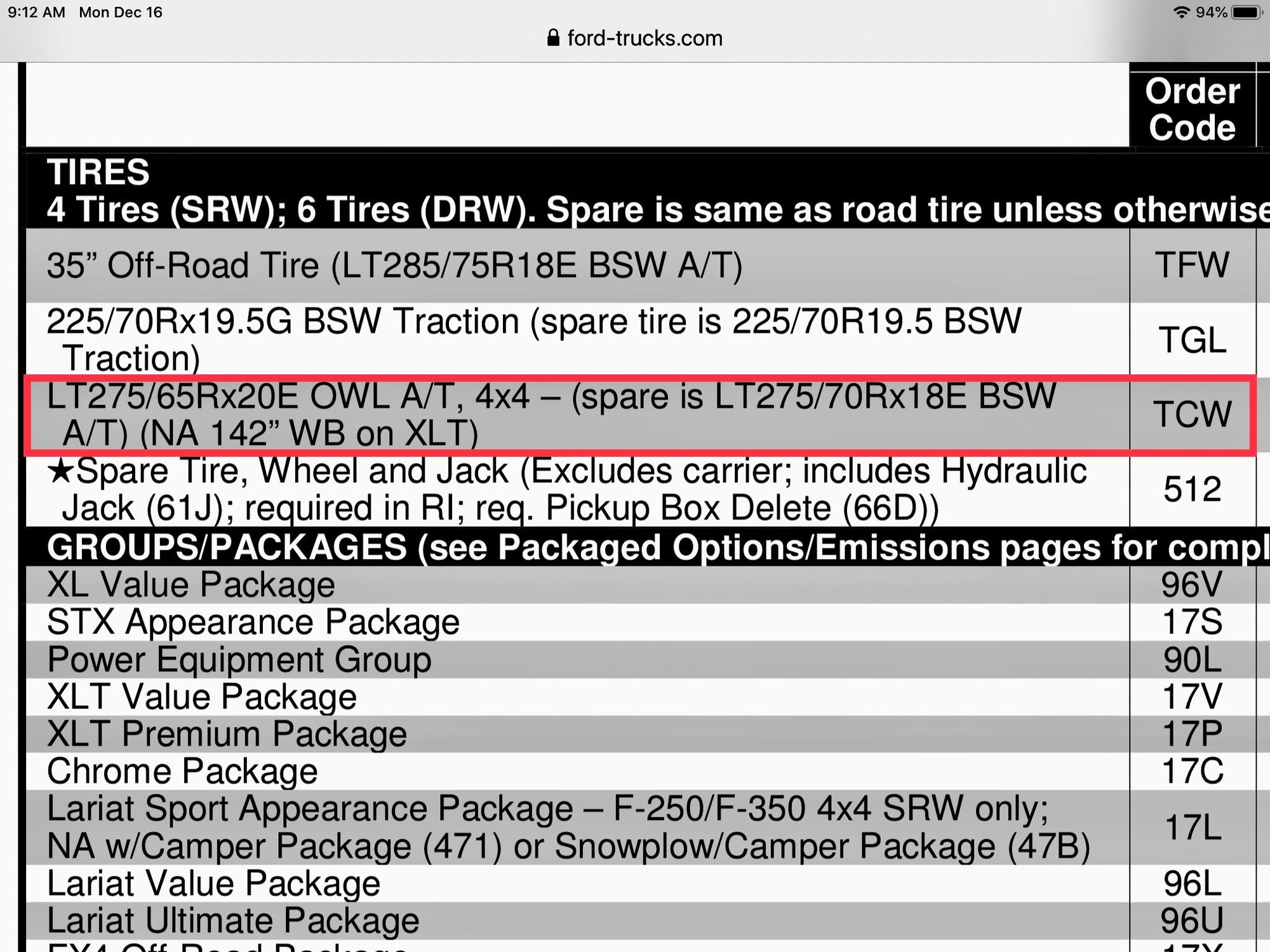

Originally Posted by Joe T
What size is the stock spare on the 20 inch wheel trucks? Saves me climbing under this thing on a gravel driveway.
It’s a 275/70R18E AT on an 18” steel wheel. From the 2020 SD Order Guide (same for the 2017-19):
HTH,
Jim / crewzer

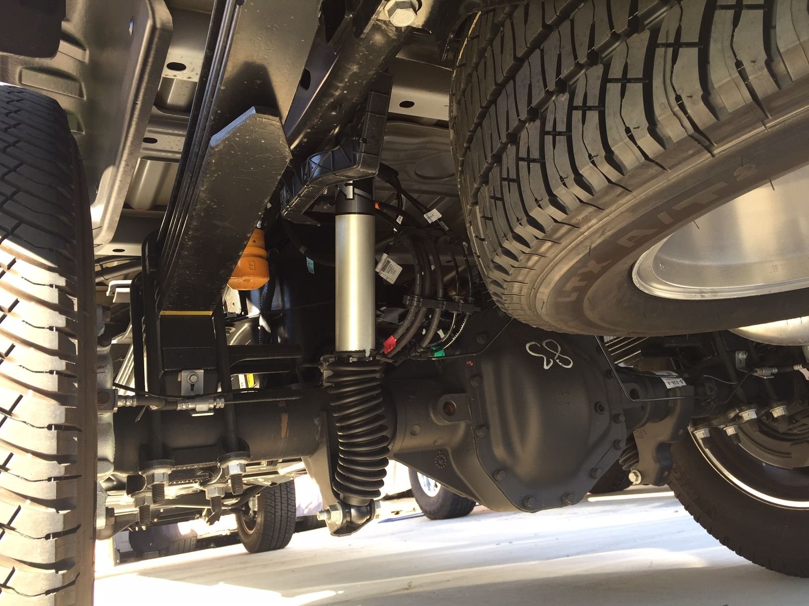

Read post #10, been down this road. Here is a pic of my stock 20” spare wheel and tire, it fits
In regards to the other questions:
Ford might have replaced them when you bought the new truck but not now.
No, Ford will not give you one cent towards the right spare. Plan on shelling out about 700 dollars for the wheel and tire.
