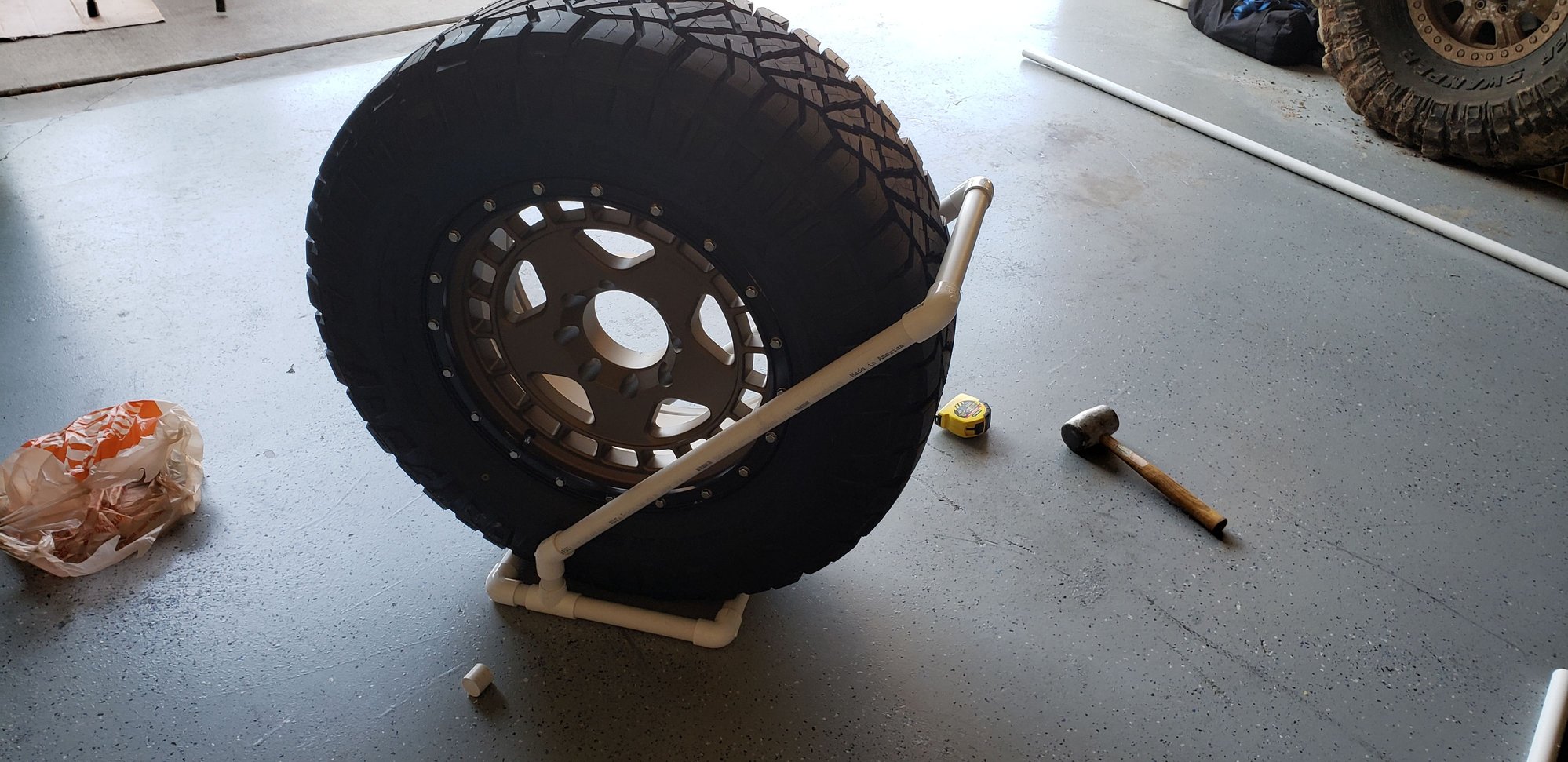

Seems like I read someone had gotten a 295/65-20 to fit, but I'm not 100% positive. I can tell you that a 37" will not fit -- I'm in the process of making a rack to bolt into my bed to hold one. Here's the basic premise. I built it out of PVC to make sure it worked before I bent it up in 1.75" tube.

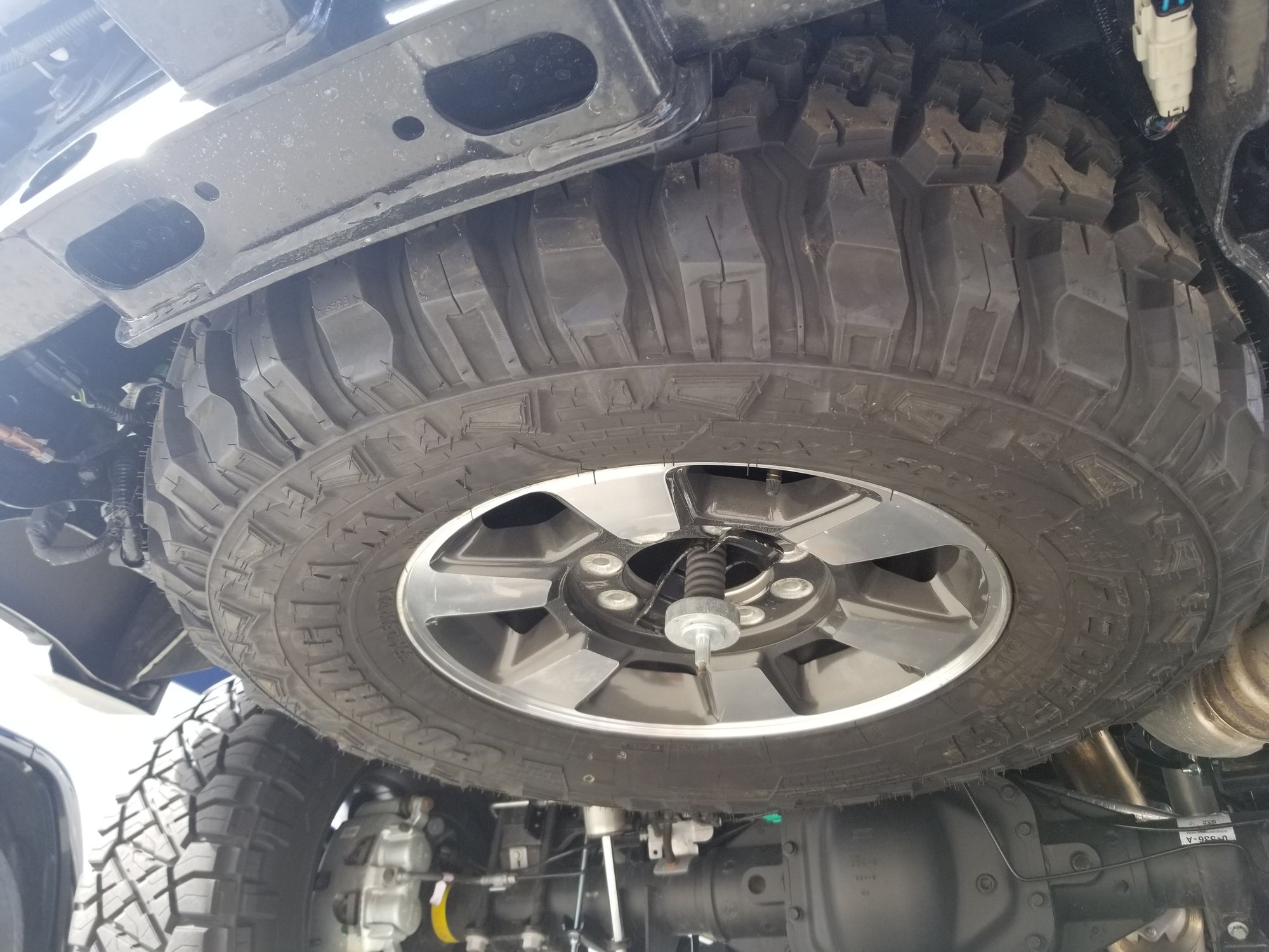

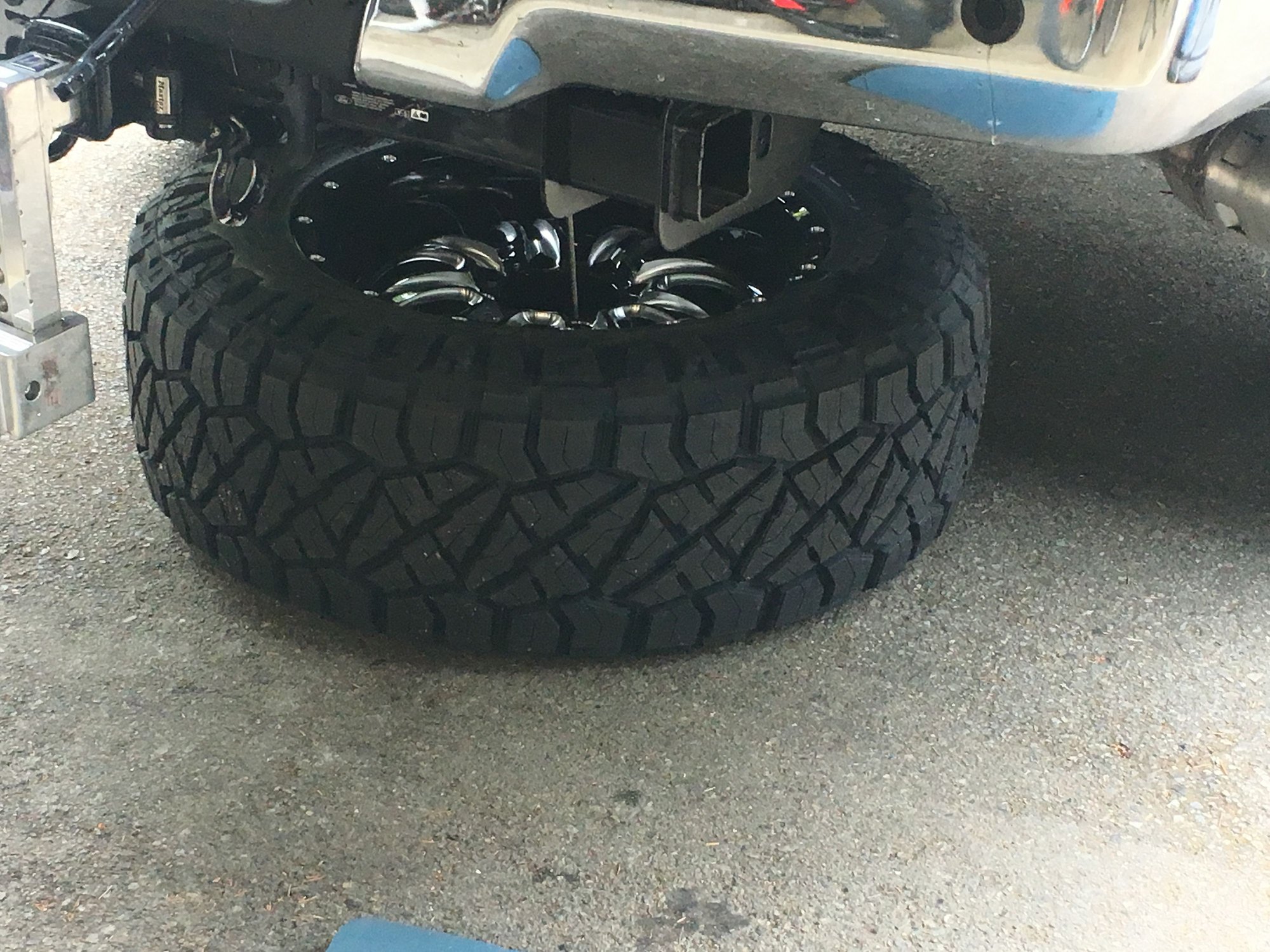

35 x 12.5 x 20 fits just fine with room to "spare"
I bought a basic tire and wheel, to save money.

I too, store my Nitto RG 35/12,5./R20 mounted in a spare 20x8" Ford Limited Alloy underneath and it fits just fine.

Ridge grappler 295/65/20 is super tight and don’t think you could go any bigger
