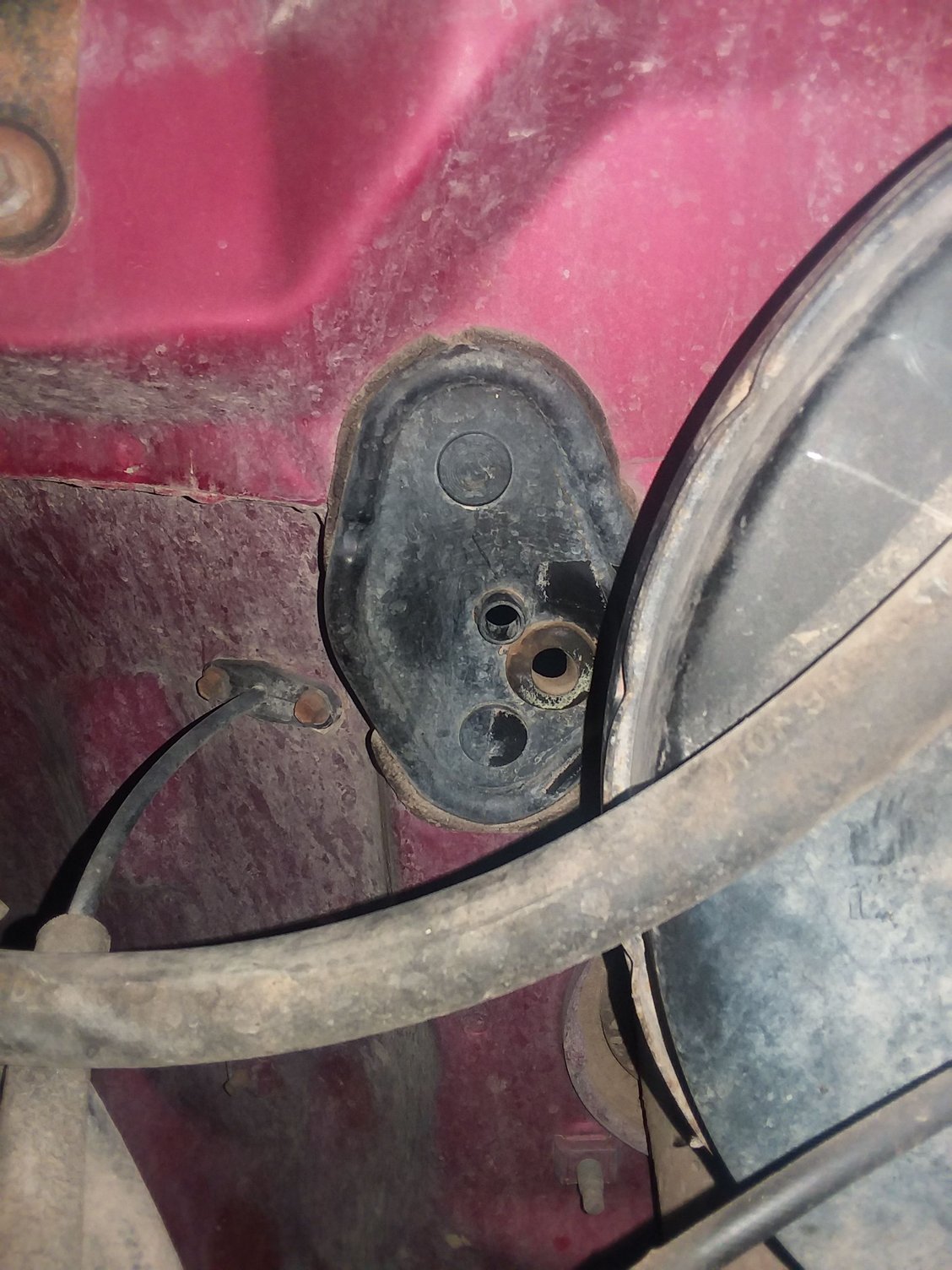

There is also these two holes in the firewall and I think these might have something to do with it
(in between brake energizer and driver side valve covers)

look at the pic with with the red lines. See that one T off? You should post your model and year for better help. Sandy
That rubber plug doesn't look like anything has been in it for a while. Have any codes?

about the holes in the firewall do those just go to some after market setup

Yeah, plug it for now, because it is a vacuum leak.
Well, if you have vacuum controlled Heat/Air C, those holes could be related. Maybe someone with an 1995 can shed some light on that...
Nothing goes there on my 1995 F150:

yeah I've got a 96 and there weren't any holes in that one eithor but there is a trailer brake that didn't have any wires to it so that might be what they go to and I think he used to have a tach in there too.
