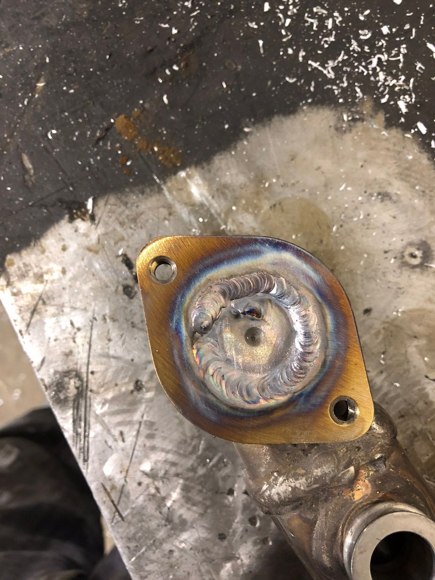

Got the spare cooler welded up
And the wet EGR valve
