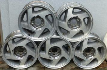

Fyi, I'm still trying to move my 5-set of early gen Exp 15's.
Anyone? PM.
