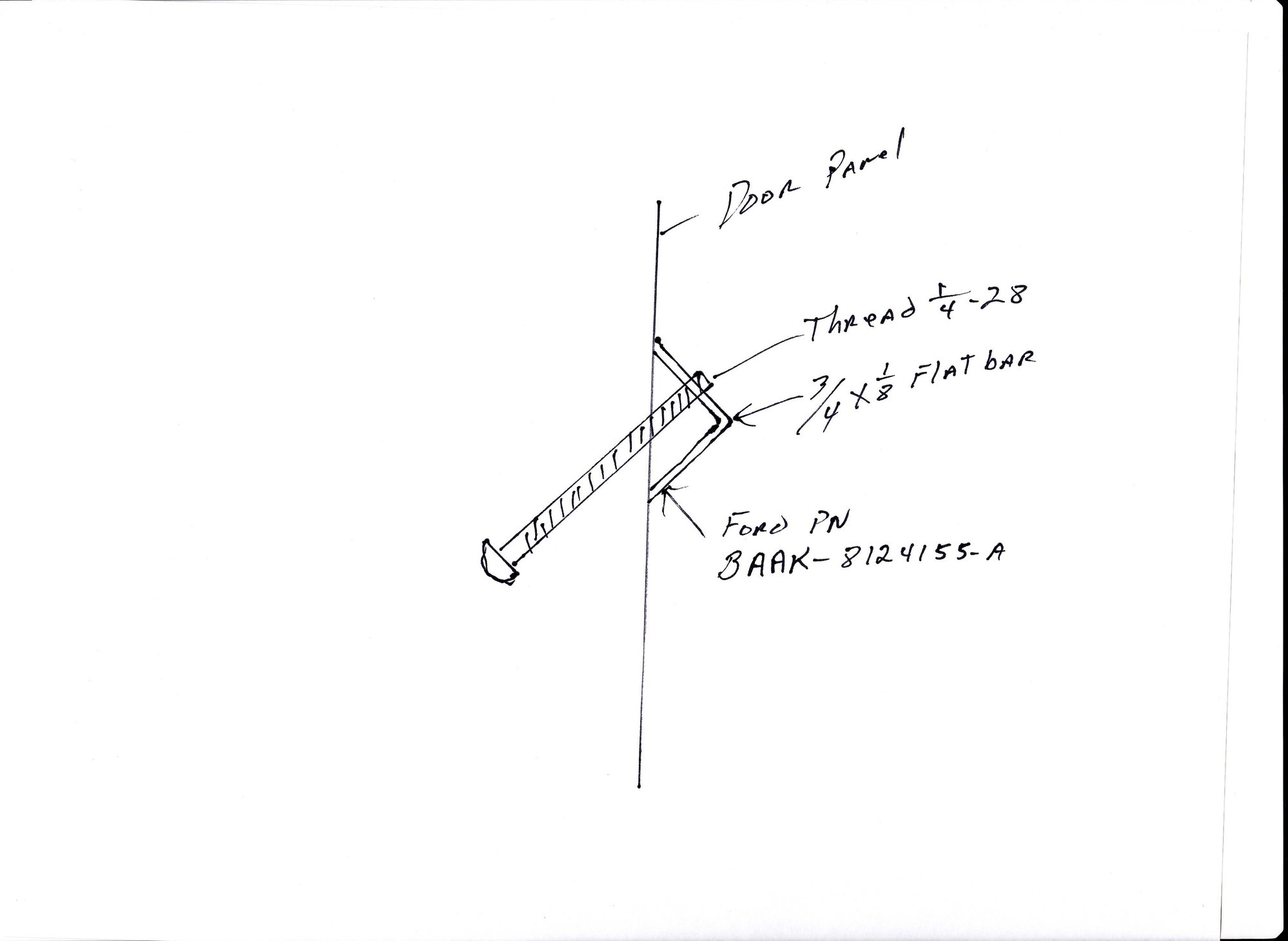

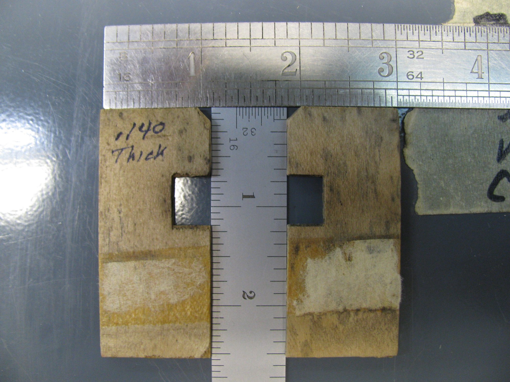

Armrest
I'm going to add a couple of pictures that another member requested in case someone needs to make these parts.
