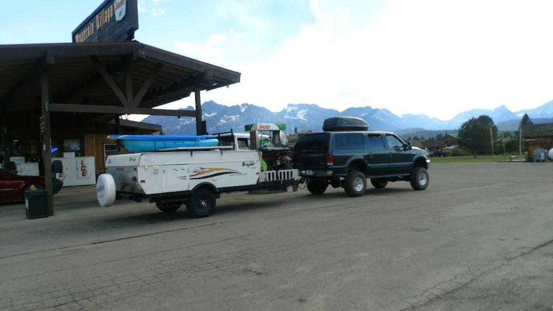

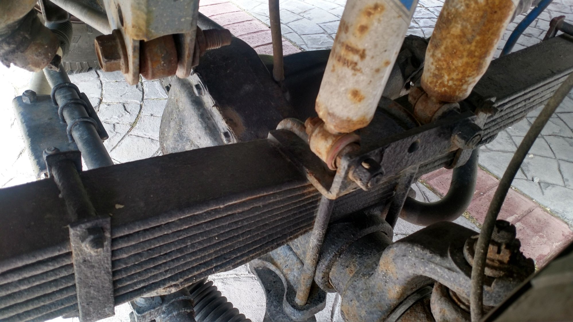

This what my rig has on it right now. Its a BDS lift of unknown height/origin, but if I had to guess, its somewhere around 6-8in to fit 35in tires. Rides pretty rough, so its all coming off. The front springs have 10 leaves and the rear is riding on a 5.5in block (no traction bars) and 6 leaves. I couldn't finish my swap before leaving on vacation this summer, so when I put the rear back together, I removed the bottom/shortest leaf from each side. Didn't notice any rear sag once hooked up to my little toyhauler. Had about 700 lbs TW when we left to go camping. The last pic shows what little sag I had, if any, when loaded up.
