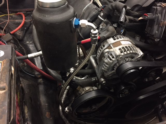

Use AN hose. if you get PTFE AN hose, its rated at 2,000 psi and has a stainless mesh exterior gaurd. its flexible and incredibly durable, and you can make your hoses at home. All you need is the correct fittings on each end- for example if its a 5/16 metal line it will have a 1/2" inverted flare fitting, so you get a 1/2" inverted flare to 6an fitting, then your line attaches to that. I've plumbed in many power steering, fuel and other systems with this and it works GREAT. the fittings and hose are reusable too.
https://www.ebay.com/itm/AN-6-AN6-St...72.m2749.l2649
Attachment 286509
