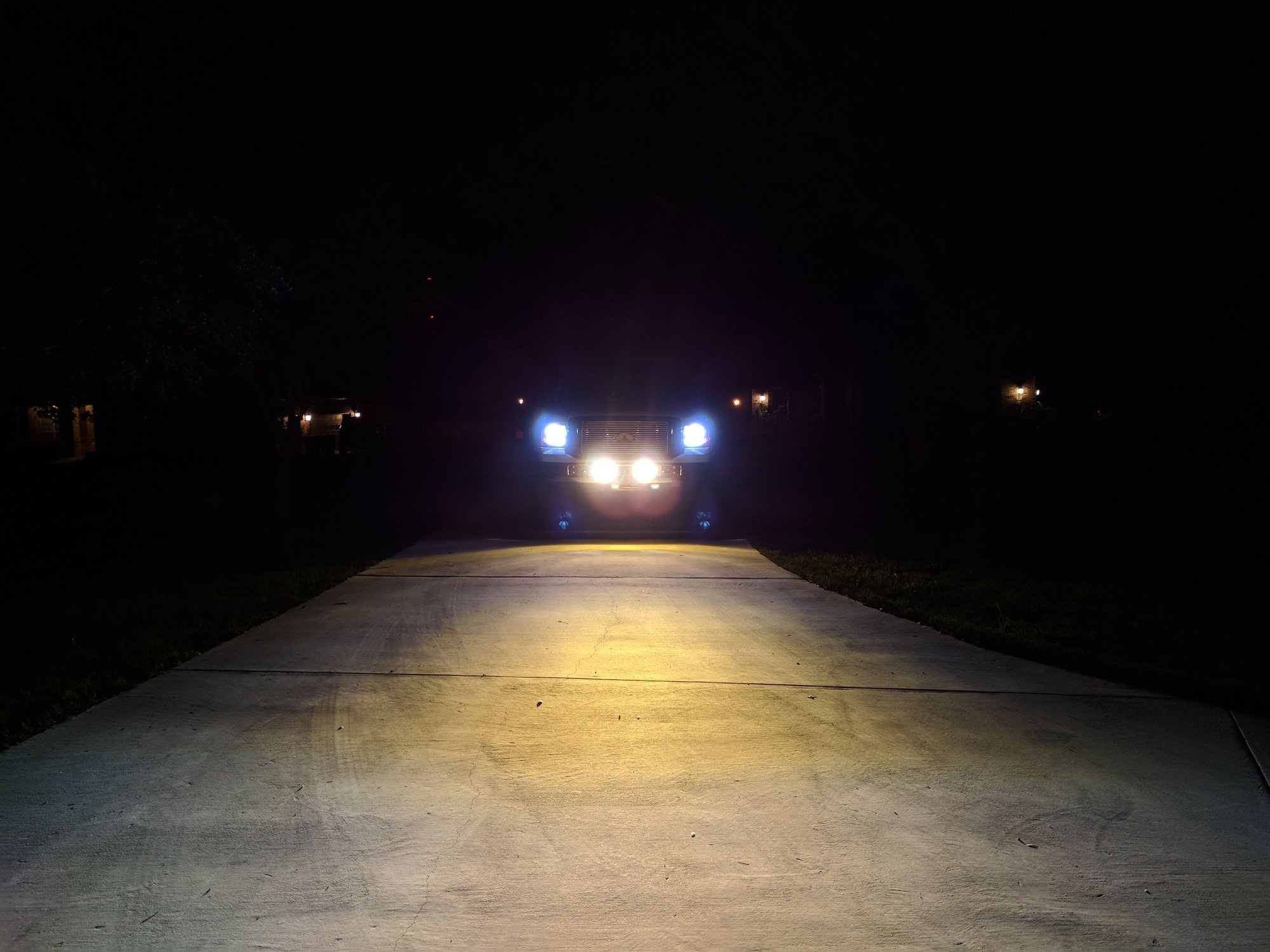

If you're looking for amber I've been very happy with 3000k HID bulbs in factory fog housings. They put out tons of light, I can happily drive at night with only the fog lights on if for some reason I really wanted to.
I went this option over Rigid because I got the same light but in the amber tint like I wanted and the cost was far less.
