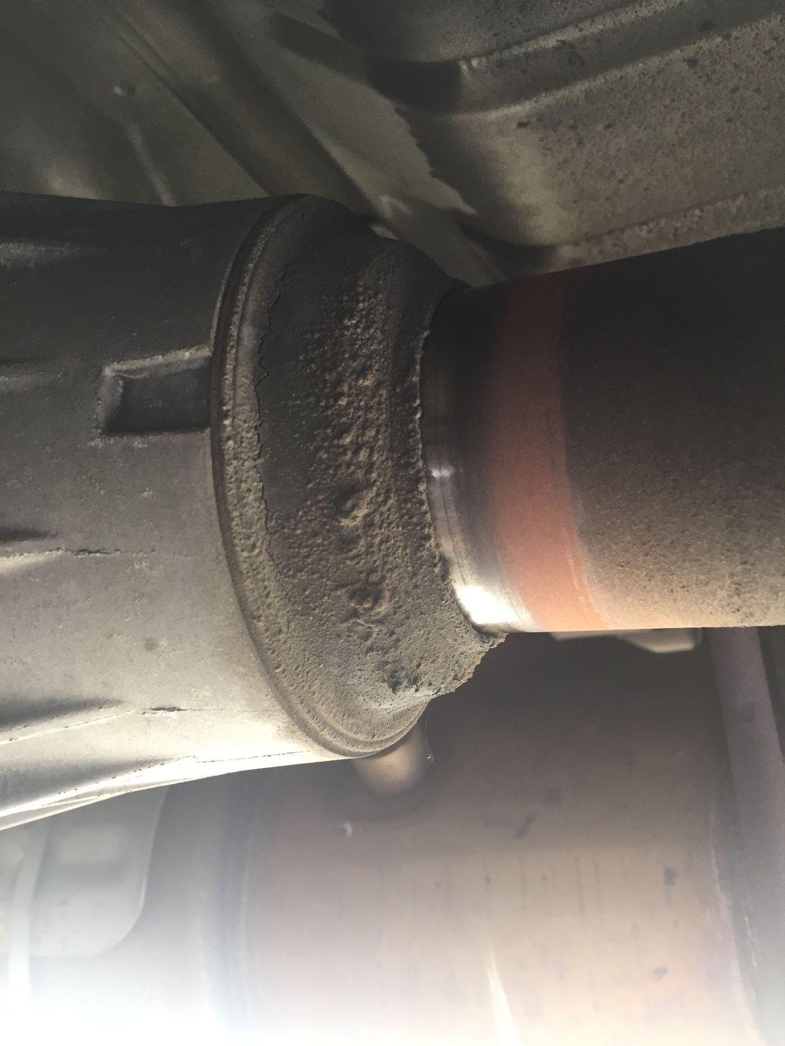

I was checking out my undercarriage and noticed this on my drive line. Is this an issue? I noticed theres a gap.

Normal, that is where the driveline moves as the suspension cycles up and down

It is rotten, cracked and should be replaced.

Wow nasty looking corrosion. Do you in the NE or place where the salt/de-ice the ground a lot?

I live in so cal, no salt on the roads. Used to work in the Mountains but they don't use salt anymore its all crushed volcanic rock.

Wow, that really sucks. I've seen that before on an old Volvo where it built up around the rear axle joints, but that was after years of it being a snow car in Indiana, and never washed. Not on a car that's doesn't see much winter.
You could try some heavy epoxy to see if it will seal up the crack for the temp, but for the long haul you may indeed need to replace it.

looks normal, don't fix it if it ain't broke

I would replace the seal, you can see the crack and evidence of leaking as it is spun all over underneath. Clean it up, scrub the crap off, pull the drive line, pull the seal, install new seal, lube drive line input shaft if required, and re install. I do not recall if you are 4wd or 2wd, if 4wd I'd probably open the t-case and ensure there is still adequate oil in it.

Im trying to find the part online but having difficulty. I wanna make sure I get the right item. Anyone have a good idea what this seal would be?
is this the right part https://www.ebay.com/itm/NEW-OEM-REA....c100854.m4779

I looked at Ford parts diagrams and was not able to come up with the correct part. Maybe a dealer would have a better way to identify the part. I think that the one you show on eBay is not correct.

2wd or 4wd? Key words I think would be 6r140 transmission output seal or drive shaft seal
4wd. Thanks ill check that part out.

Is that a slip yoke on the transfer case? When did Ford start doing that?

not the transfer case, the pictures is looking toward the rear of the vehicle.
