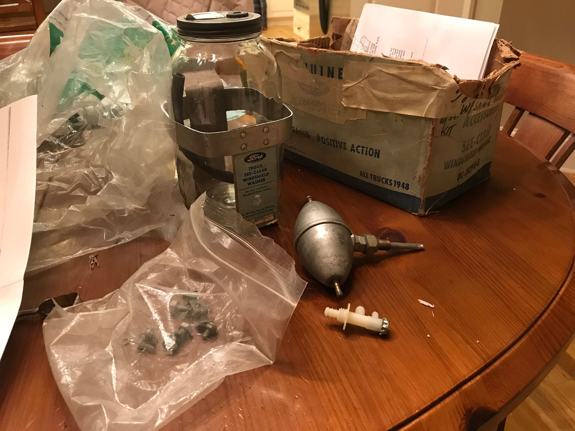

so I scored an original see clear windshield washer and most of the parts (I think I was missing one). The foot pedal on the pump was missing but I sourced that and it's on the way. The directions seem to indicate that there might be a spring under the foot pedal, between the firewall and the pedal. If anyone has this option can you check that and post a picture of it?

Yes Abe I have the nozzle. It's a strange bird as it is a chrome piece with a clamped end that attaches over the windshield seal and the other side extends into the cowl through a drilled hole. Will take pictures tonight.
Yeh I don't have that spring, anyway you can take some measurements of length and OD of both ends if it's conical?

I will try to measure that spring tonight. Did you get this on eBay? Is it NOS? It looks great.
Your bottle holder looks different than mine. I bought the decal and I had to trim it as it was too wide. It was advertised for 48 to 52. Now I see why mine didn't fit. Your center bar is wider. Is that spherical thing the diaphragm? Mine is different. I've got copies of the 53 to 56 instalation directions .

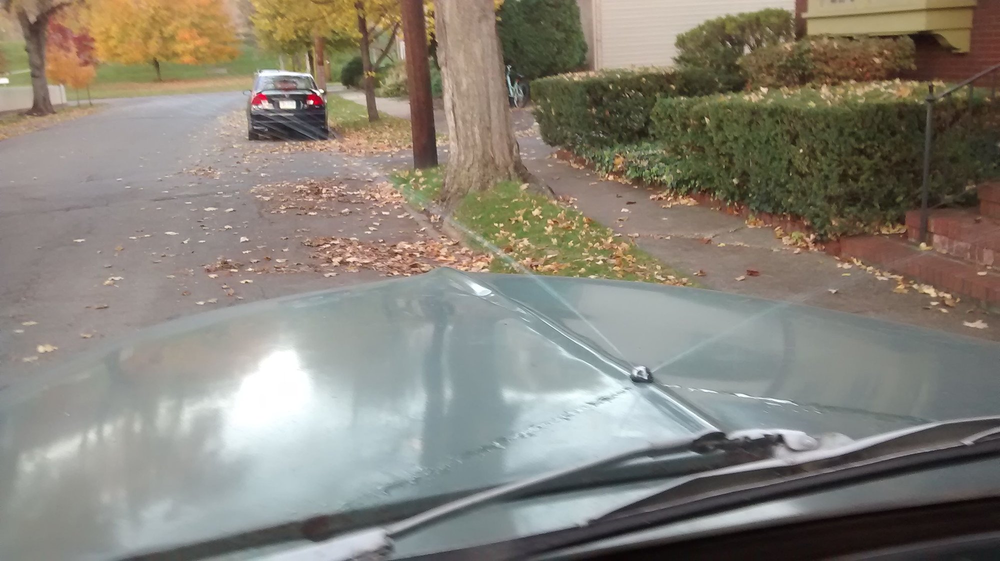

Here is the location of my nozzle. Yours must be different than the 53 to 56 nozzle.

Yes on eBay. I think the pump changed in 52 to what you have. Surprisingly it had everything except the spring and pump pedal and I don't think I have the fluid strainer, but I see mid-fifty has that.

Here is the nozzle installed on my '49 F4. The nozzles on each side are ball shaped and adjustable. I'm going to use a washer bag from a '66 Ford car and an electric pump.

thats it Mark. Do you have yours in the very center of the windshield? How does your foot pedal look? Does it have the spring also?

JB, Yes the nozzle is centered in the windshield. I only have the nozzle, I didn't buy the rest of the kit. I bought the nozzle NOS from McDonald Obsolete Parts. I saw a complete kit for sale on ebay a couple of years ago and the seller had a very clear photo of the installation instruction sheet. It showed exactly where to drill for the nozzle. It also gave the part number for the nozzle, so I called around until I found one.
