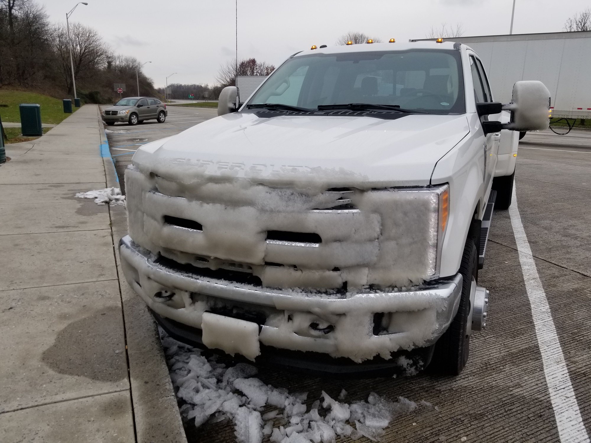

I really liked them... Until winter came !
As soon there's snow falling, it sticks to the light and I can't see nothing...
Ford should put some kind of defrost on them

Ruh roh - I hadn't thought of that. LEDs burn cool. No heat = no snow melt.
Maybe coat the lens cover with RainX?

Yep my Freightliner work truck has LEDs and does that all the time. Its a huge pain and is the exact reason why I got the halogens.

We have the same issues on our CAT equipment that now arrives from factory with LED lighting. For heavy snow clearing applications, we've actually swapped back to halogens since they melt off the snow and ice.

Drove all last winter and now the start of this one and never had them ice up like that. Mind you its far colder here and the snow cant stick like that. I could see where wet falling snow and temps around freezing would have this happen easily. Definately a downside of LED. I have also noticed the tail lights could be an issue with sticking blowing snow as well. Something to consider when driving in these types of conditions, clean off headlights and taillights....

I thought about that for winter driving when I am up north. I had thought about getting 2 12v flex heating strips. Running them around the outside edge so it didn't look 2 ugly since they are orange. Wiring them up the a aux switch. IDK if it would generate enough heat on the plastic to just keep it from sticking or on the opposite end of the spectrum get to hot and deform the plastic. Just an idea I was kicking around.
