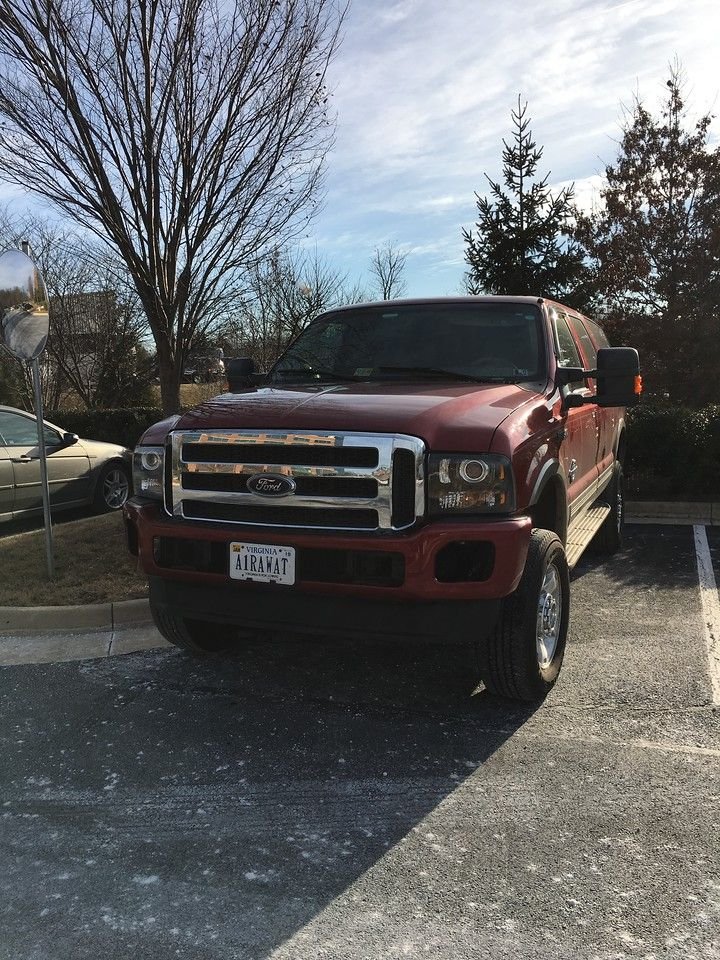

I went with the cuts in the '00 header panel route and the modified 05 grille while doing the headlight swap. I agree with the OP that it looks flimsy in certain places. It was also tough in my case to get the headlights to be aimed right. That's a long story ....
The best HID setup, IMO, would be a DIY using good components. I am a big proponent of the Morimoto projectors and HID kits sold by The Retrofit Source. I have bought 4 sets from them so far for different applications. Great products and excellent support from their Customer service. I have heard mixed reviews of the aftermarket stuff available on eBay or Amazon. Though it works well, I am not at all happy with my current HID setup on the EX. Working on a retrofit of a LED projector, along with a '15 front bumper mod. At some time later in the year, I will swap out the header panel from an 05 to get the full grille and also be able to completely line up the bumpers. Not the best angle for a picture, but here's where it stands for now. The fog lights are HIDs from TRS too.
