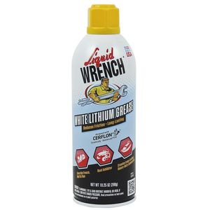

Might I suggest you open it the spray the handle mechanism w/ Liquid Wrench lithium spray. Raise/extend the handle several times after spraying to fully distribute the lube. Give the 2 hinges on either side of the tailgate a shot as well. Believe you'll find it works way mo' betta afterwards.

Take it to the dealer. Mine was replaced a few weeks ago. I took it in the first time and they lubricated the snot out of it (making it quite messy) but that only made it pop out 50% of time. For round two they replaced the entire mechanism. It works good now.

DO NOT lubricate it.........in time it will become a dirt magnet, then you will really have a hard time opening it. Do like HRTKD posted......take it in and get it fixed right.
