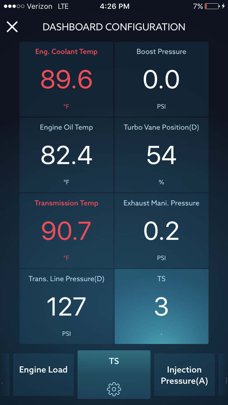

And this is a good screenshot to save

The "ts" pid
In my screen shot its on power level 3
