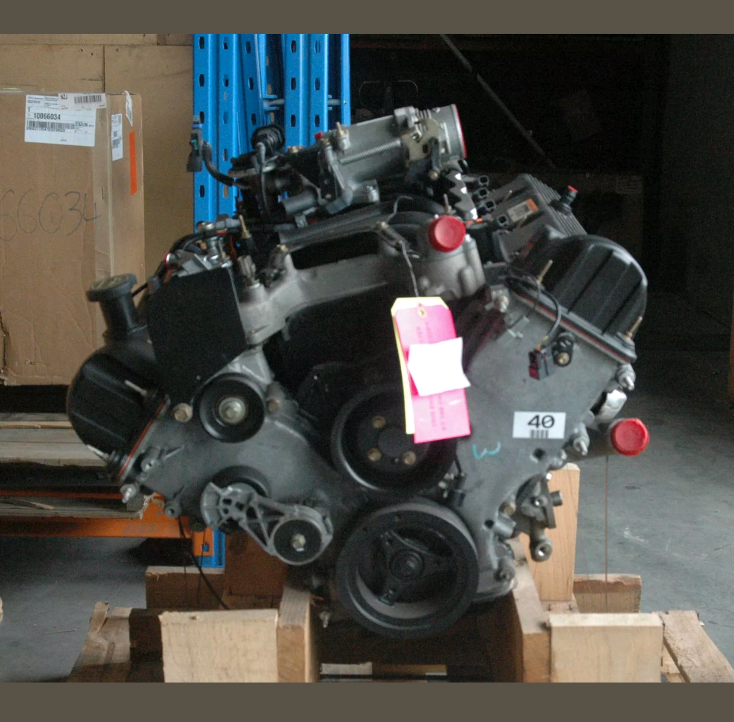

Hi. Im looking at a new 4.6 to fit to my 97 f150 . Can anyone tell me what they think this motor might be out of. Its a romeo pi. I googled the number on the tappet cover and came up with crown vic. Has a 6 bolt crank. The seller thought it was ftruck. Basically as far as i know it comes down to sump and manifold. Who can tell me more.

Definitely came out of a crown vic.

THANKS. My understanding is that i would need to change the sump, pickup and manifold to use in an f series. Is that correct.
