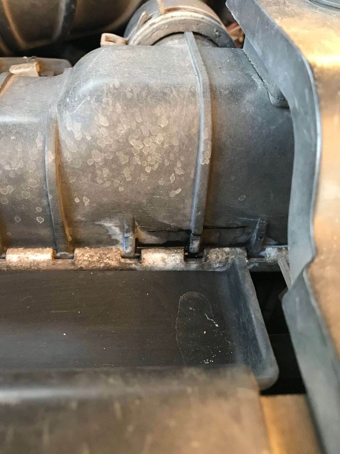

I found a small leak/crack in the top plastic tank.
do you fine folks have advice on brand name preference? I figure Motorcraft will cost half as much as a new van
I have no idea what to buy. Local auto parts stores of course will be my best bet for warranty. But Rockauto will have the best price

I actually don’t need it in a huge hurry. I saw it again today and it looks bad but apparently not losing much coolant.
Im liking the idea of getting it fixed. But I didn’t think they could fix a radiator with plastic tanks.
Ill post a pic tomorrow morning.

Rock Auto all the way. Got a GREAT radiator for my old BMW from them for $100ish when the dealer wanted $450. It is a Nissens brand which I found on the Internet was superior to the OEM version.
Don't fix a radiator with plastic tanks; they are throwaways. Just order a new one and put it in.
From what I gather, your van doesn't need to run for more than a year or three longer. Radiators are a commodity and you don't need Motorcraft for that. Maybe do a quick bit of research on some of the alternate brands on the web and find one with generally good feedback.

Call (800) 433-6309 and order a new top tank with a gasket for $25 and replace it yourself.

Yuk....crimping aluminum tabs on an old radiator with vise grips strikes me as a shaky process, and Murphy's Law says the core will end up leaking soon anyway. I'd buy the $125 level Rock Auto in a brand like Denso that makes OEM radiators and have a completely fresh unit. When I was a kid with no money, I would solder cracked radiator tanks but in those days they were copper...(talk about recycling value). If the plastic is cracked in an accessible place where you could keep it clean and dry, you could also clean out the crack, rough it up, and load it with epoxy or JB Weld. But $125 for a new Rock Auto radiator is the cost of 1 hour of shop rate labor...

I agree the aluminum tabs could break off but for some with little funds, replacing the top is the way to go..
Here is a shop with a machine to do it..
Here is a shop with a less expensive set up for crimping it back tight.

Here’s what I’m up against.
