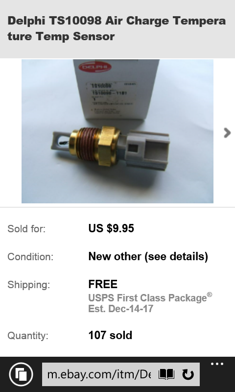

I can't find the thread, but I stumbled on it years ago. I've had this saved in eBay since then... Delphi ts100098
That is not a Ford sensor pictured there...
Old Dec 8, 2017 | 01:10 PM
timmyboy76's Avatar
timmyboy76
Joined: Sep 2010
Posts: 7,793
Likes: 50
and your point...
and your point...
Ummm, only OEM Ford sensors for these truck?
Old Dec 8, 2017 | 06:12 PM
Rikster-7700's Avatar
Rikster-7700
Joined: Aug 2006
Posts: 1,465
Likes: 17
From: Jacksonville, FL
Yes this!^^
Aftermarket sensors are known to not always play nice with these engines....
