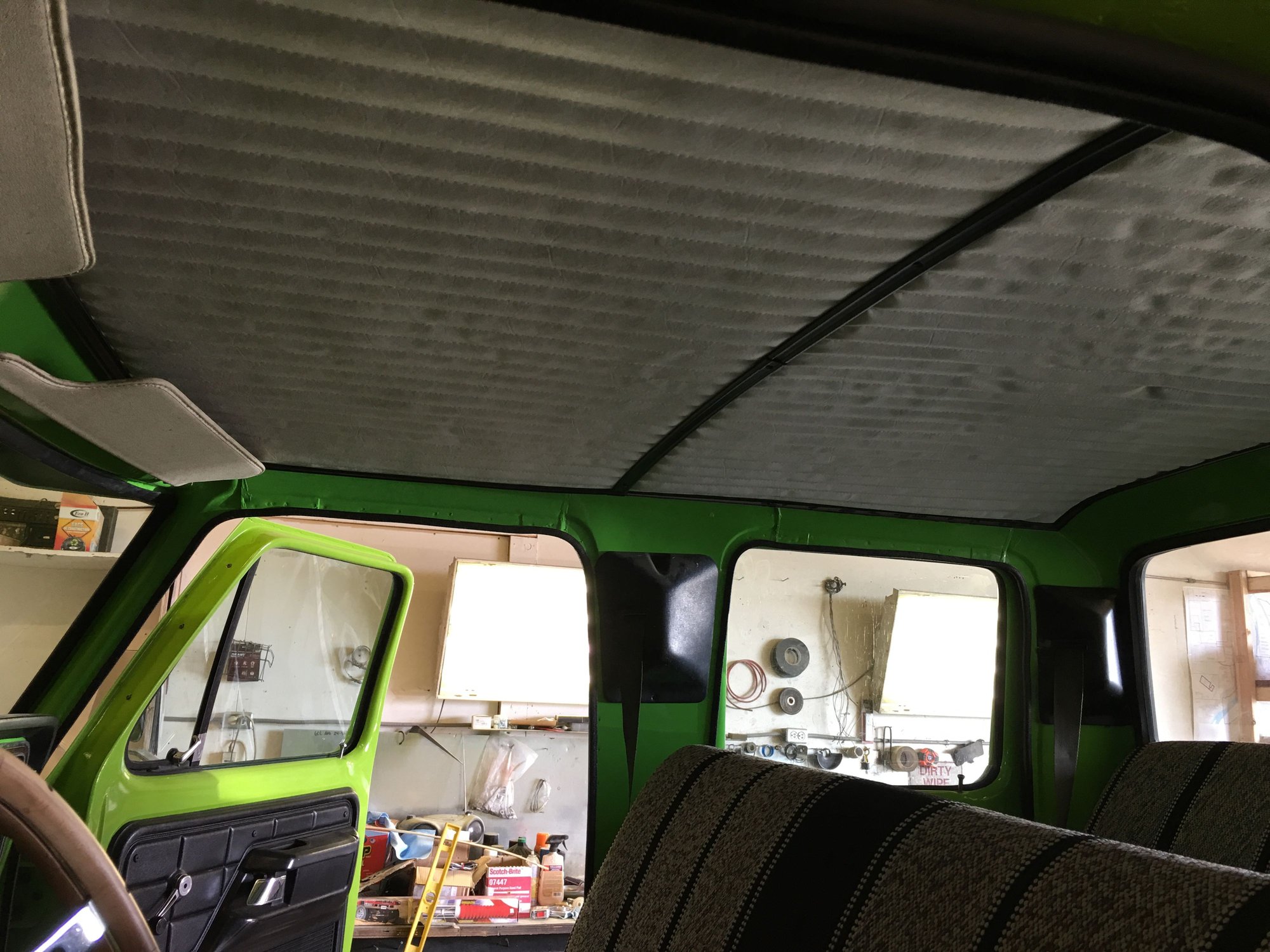

I made mine but I had the factory cardboard for the template. I used this ribbed plastic stuff they sell at hardware stores for green house panels. It’s called chloroplast here... it’s light, the ribs provide enough rigidity but enough flexibility to match the curves. I was happy with the result... the wrinkles all faded with time...
