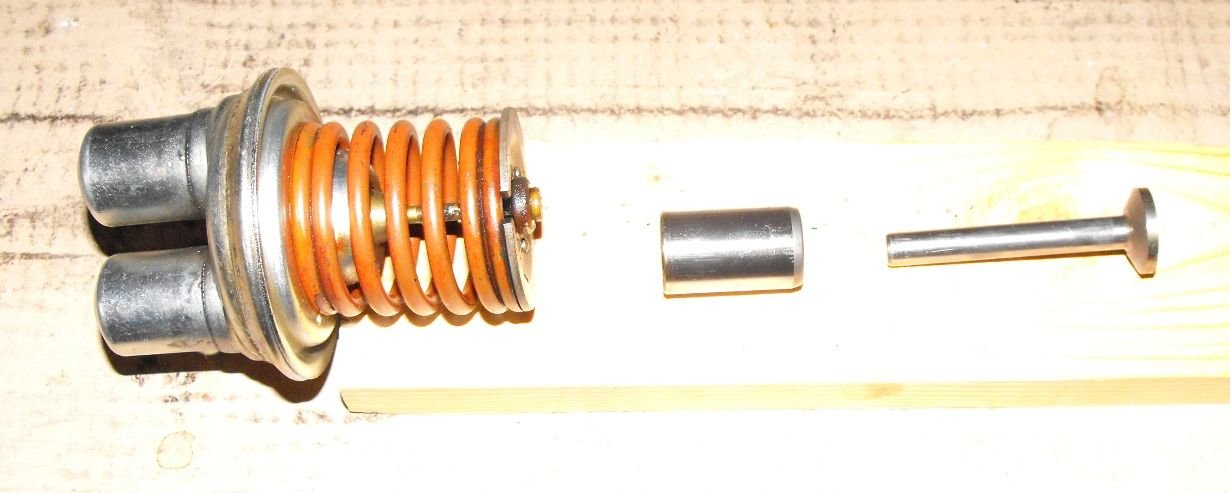

I can't see any way the piston could break. You have the push tappet that runs off the cam and that is held in the bottom of the pump by just an o-ring. Maybe the mechanic thought that was connected to the piston somehow but it's not. It just pushes the piston up when the cam pushes the tappet up. When the cam goes down the piston is pushed down by the Hugh spring compressing the fuel.
Here is a picture of that assembly disassembled. The piston is a big hunk of metal:
If the piston broke then you would not have much fuel pressure but you're indicating the truck runs fine. Above the piston there is a space where if fuel gets past the top seal, just another o-ring the fuel would drain out the weep hole and into the valley. Even with a worn upper seal the truck usually runs fine, it just leaks some fuel from the weep hole.
Here is a picture of the piston hole with the piston inserted. You can see the upper seal at the top of the hole and at the bottom is the tappet seal, hard to see in the picture. Also the weep hole is located about the 8:00 position. With the pump installed on the engine the weep hole is towards the passenger side of the engine facing down, towards the valley.
I have to ask why the mechanic thinks the pump is failing, and so do you. If fuel is leaking from the weep hole again with such low miles then there must be another reason. The only thing that comes to mind is maybe the fuel pressure regulator is bad (to much pressure) as that would cause excessive pressure on the piston's upper seal causing premature upper o-ring failure. But this is just a guess. Once that upper seal is compromised the pump may work fine for awhile but is toast as there is no fixing it. Do you know what your fuel pressure is at idle?
As far as pumps go they are all made by Carter. You can spend $200 somewhere or $90 elsewhere. There are no better $$ pumps out there as they are all made by the same manufacture, but you can spend more money if you want. Prove me wrong?
There are so many places for fuel to leak in the valley, and we can give you some areas to look at so don't just assume it's the pump again, unless you know for sure it's from the actual pump.
