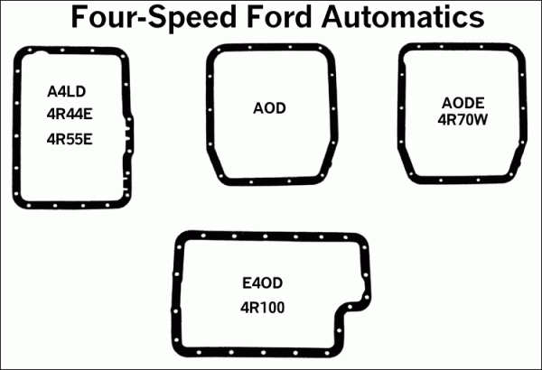

hi can anyone tell me what trans this is the pan measures 13x 16 code on the door sticker reads trans and t, the truck is an 1993 flare side 302 4 wheel drive. vin 1FTEF14N4PKA22663 thank you for any help

Trans code T is for an AOD. Is there a button on the end of the shift lever?

Do you have OD button on shifter? No. Then AOD. If it has the button, AODE.
Which one does it look like?

no button and i just counted 14 bolts
