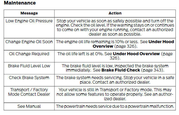

I just crossed 9K miles, and am at 9% oil life remaining as indicated by Forscan lite.
I do not see a "Change Engine Oil Soon" message as indicated by the Owner's manual. If I did not have Forscan lite, I would not even know I am below 10%.
Or maybe I am not looking in the correct place for the message? I get a lot of messages when my door is open, collision avoidance inoperable, etc. Is that the same place the message should show up?

I finally got a response from my dealer. The Service manager said it takes a 5% oil life remaining to trigger the warning, and a 0% to trigger the change now.
What is so hard about showing the oil life remaining during the entire cycle, I am not sure...
