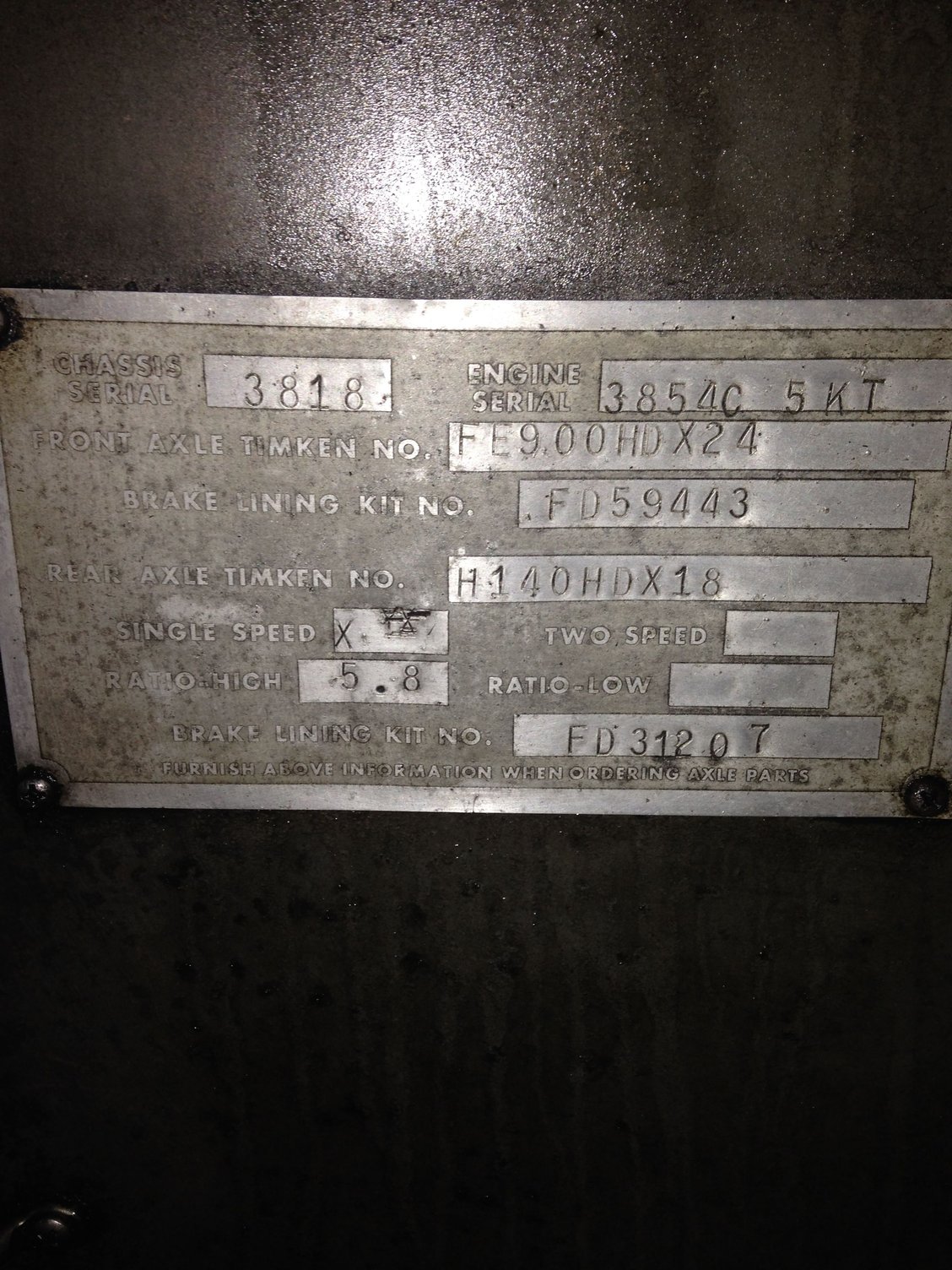

Here's the tag on top of the doghouse. It reads
Assume one of these wil suffice
Front Axle Timken number: FE900HDX24
VIn listed on previous owners registration is FL900HDX24 if that makes any difference.

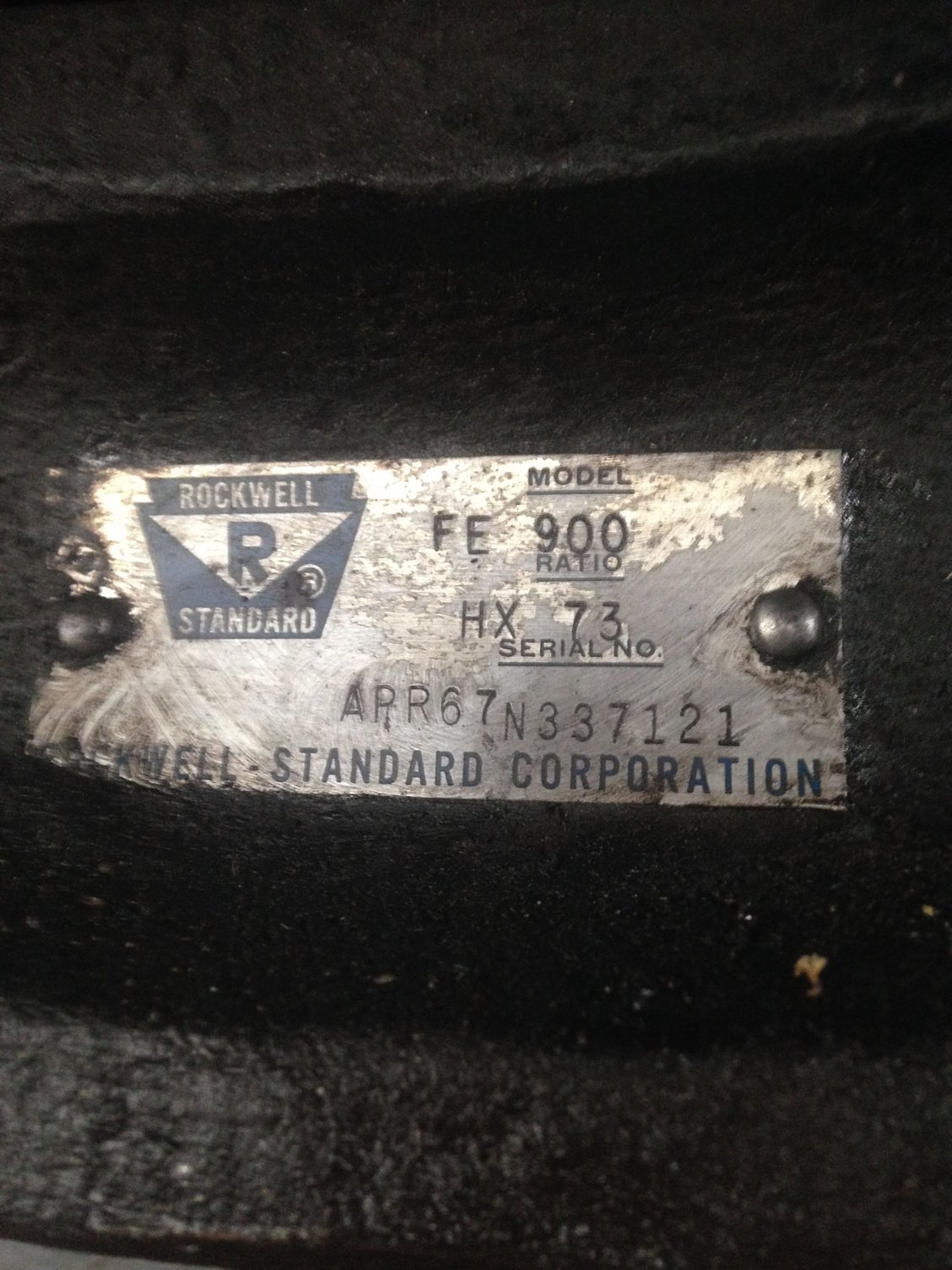

Here's axle tag too
VIN listed on previous owners registration is FL900HDX24 if that makes any difference.
VIN is not FoMoCo related. FoMoCo VIN has 11 digits, first 5 digits would be either B60FU or F60FU
B = School Bus, or F series. 600 could also be 500 or 700; F = 391 4V FT engine; U = Louisville KY Assembly Plant (pertains to rolling chassis).
