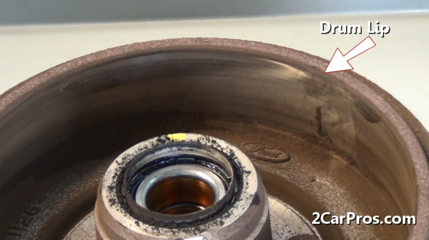

When you have the drum off check it for a wear edge, this can make the drum tight to remove/replace over the shoes but still allow additional shoe movement space once assembled that gives excessive pedal travel.
There is also a rubber bung in the brake backplate close to the star wheel. Once you know which way to rotate the star wheel to close the shoe clearance you can remove the bung and access/adjust the star wheel through the small opening with the drum on. You have to know what you are trying to do as its mostly blind and by feel but possible. Replace the bung afterwards ;-)

Wear edge - AKA a lip on the outer part of the drum that prevents easy removal or installation of the drum over the shoes. The larger the lip, the more adjustment required to have the shoes properly seat on the drum and if not adjusted, results in more pedal movement/soft feel due to the increased movement of the shoes required to engage the brake.

Ideally, there should be no lip or wear edge. I'm personally not a fan of having drums turned to remove the lip. The cost of a new drum is not much more than the cost to turn one.
