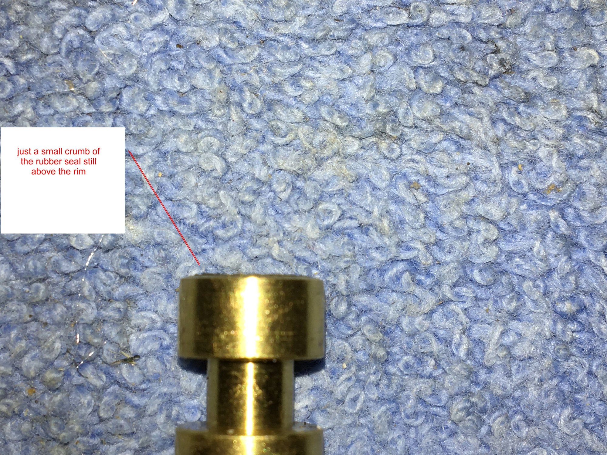

. went out and removed the hyd unloader and looked at the pieces... the rubber seal in the spool looks like i's broken down and it's top is even with or below the top of the brass of the spool. Seems like it should be a little bit proud of the housing...see pics
might as well order a new rebuild kit and get it on the brown truck asap... any guess what makes these rubber seals break down so fast ???
Old Nov 10, 2018 | 07:36 PM
FuzzFace2's Avatar
FuzzFace2
Posts: 30,914
Likes: 4,123
From: Angier, NC
What oil are you using Quincy oil?
I never had that go bad on the ones at the hospital I worked at it was always the rubber diaphragm under the mushroom thing at the top.
With the heat the head gives off it dries out and cracks.
I also like your air dryer.
It looks like it is between pump & tank? How good does it work?
I also have a dryer but it is after the tank and before the piping around the shop.
And as a last stop for the water each of the 5 air drop / hose connection has a drip leg.
Dave ----
Old Nov 10, 2018 | 09:34 PM
jniolon's Avatar
jniolon
old and in the way
Joined: Jul 1997
Posts: 5,921
Likes: 1,052
From: Lovely Hueytown Alabama
using 30 wt synthetic
yea, I replaced that last time.. it was just old and brittle
yes, between the compressor and tank...took a lot of water out of my piping system
even on 90-100 degree high humidity days, my air stays dry. and a lot cooler... I drain the tank often but
probably a cup full at most
nice set up there... I like that speeddaire hosing system
Dave ----
thanks for the reply
Old Nov 12, 2018 | 09:01 AM
Brownac1983's Avatar
Brownac1983
Joined: Nov 2017
Posts: 44
It could be the synthetic oil, but then again maybe not. I'm not sure what those seals are made of. Did you replace the spring when you rebuilt it? If not, you might try that, it could be chattering. Those seals should last at least a few years even with constant use. But if you depend on your compressor keep a couple on hand.

Old Nov 12, 2018 | 09:25 AM
jniolon's Avatar
jniolon
old and in the way
Joined: Jul 1997
Posts: 5,921
Likes: 1,052
-Drew
yes Drew... replaced spring, piston and rod. I can easily change back to dino oil.. it's just a quart or so... got a rebuild kit on order, waiting on brown truck.
john

Old Nov 12, 2018 | 01:42 PM
Brownac1983
Joined: Nov 2017
Posts: 44
Originally Posted by jniolon
not compressor oil..just generic syn... Castrol if I remember correctly
It shouldn't have anything to do with this issue, but in general you want to use a non-detergent oil for compressors. Auto oils contain detergents that are designed to keep dirt and debris in suspension so the oil filter can catch them. On applications without an oil filter (compressors, small engines, etc), you want a non-detergent oil so any dirt or debris settle to the bottom instead of stay in suspension to be repeatedly splashed onto the cylinder walls. You can buy purpose-labeled compressor oil, but any non-detergent oil will do. It's not going to hurt anything short term, just something to keep in mind for the next change.
Old Nov 13, 2018 | 07:39 AM
FuzzFace2's Avatar
FuzzFace2
Posts: 30,914
Likes: 4,123
From: Angier, NC
It cold be the oil like brown pointed out and why I asked what you were using.
At the hospital we used Quincy oil on the 2 Quincy compressors and Kaeser oil in the Kaeser screw compressor.
In my home garage the SnapOn compressor I use oil made / marked for air compressors.
It also does not use that same type of un-loader like yours. It uses a check valve just before the compressors out let line that goes into the tank.
That is 1 reason why I did not run the air thru a cooler before it went into the tank like you did.
That check valve was also why I think the compressor was taken out of use. I found the starter control contacts welded closed from trying to start under load, so the unit would not shut down when it got to PSI.
I also had a Craftsman 30 gal that had the same type of check valve that failed and would not let the compressor start.
I think if it was me I would do like you did the last time and rebuild that oil psi loader and replace the rubber diaphragm at the top and use an oil made for air compressors so it would not hurt that loader rubber seal.
Dave ----
Old Nov 13, 2018 | 09:25 AM
Brownac1983
Joined: Nov 2017
Posts: 44
Dave ----
Agreed. And I'd keep a spare unloader kit on hand just in case. It's only a minor annoyance to rebuild it every year or two if you have the parts on hand, vs. having your compressor down for a few days in the middle of a project.
Old Nov 14, 2018 | 08:58 AM
jniolon's Avatar
jniolon
old and in the way
Joined: Jul 1997
Posts: 5,921
Likes: 1,052
FF so do you think ANY compressor graded oil 30WT ND would do ok ?? i.e. Ingersoll Rand or Amsoil ?? I like the idea of synthetic because of the longer life and less buildup in the pump. Parts won't be here till monday so I got time to find some.,.,,. just hate to order online
