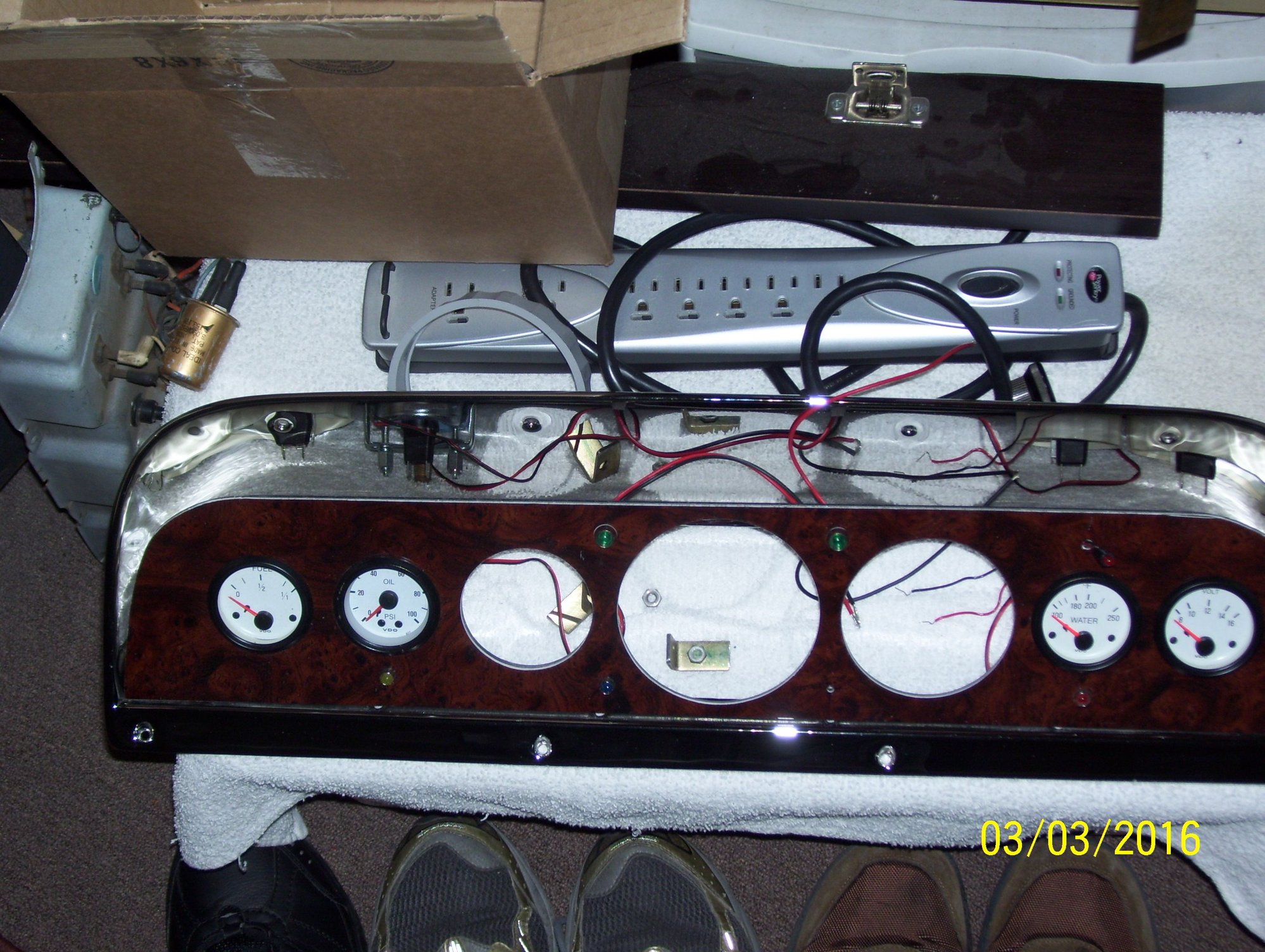

I'm now using one from VDO that matches my after market fuel gauge.
As, I custom made a dash clusters with all VDO gauges.
